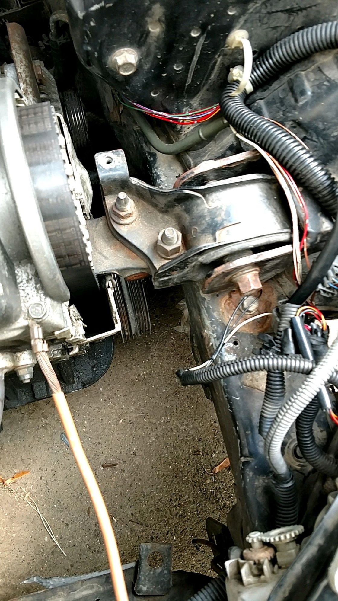

So I purchased what seems to be a Frankenstein Methed up 99 honda DX and I'm diligenting trying to make this car run and drive safely starting with the motor mounts which are shot. I'm having a heck of a time identifying an appropriate matching motor mount. It is also missing the lower motor mount cam side. Does anybody know what motor this mount goes to? Also what should I search for when trying to find a replacement. I do not have access to the car at this time but I will tommorow.https://cimg1.ibsrv.net/gimg/hondafo...f303ce225e.jpgMissing Mount location. What Mount should I purchace.
https://cimg3.ibsrv.net/gimg/hondafo...ff7af3e96b.jpgThis is the motor mount I cant find anywhere. Ive searched 3 local junkyards and browsed the internet.

welcome to the forum. have you tried hondaautomotive parts to locate the parts you may need. also hondapartsamerica.comd

D series motor
I found the block number and was abled to pull the mounts off of a 93 civic.
