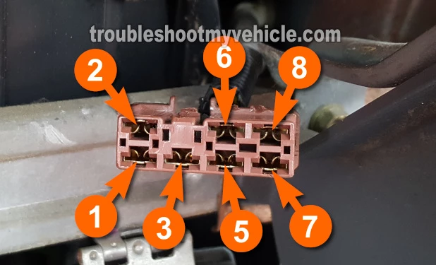

The other day I was driving to work and suddenly the car just shut off and I wasn't able to start it, at first I assume that it was a bad fuel pump, but after a number of checks I was able to locate the problem, it was that terminal no.5 on the PGM-FI(add photo) relay wasn't getting 12 volts (YELL/GRN) thus it won't click and send power to the fuel pump. The weird thing is that I also checked all the fuses under the driver-side dashboard and all was fine (SRS, fuel pump...),
CAN SOMEONE HELP ME TO UNDERSTAND THE PROBLEM AND FIX IT? THANKS. sorry for my English.

Check fuse 13. 15 amp.
