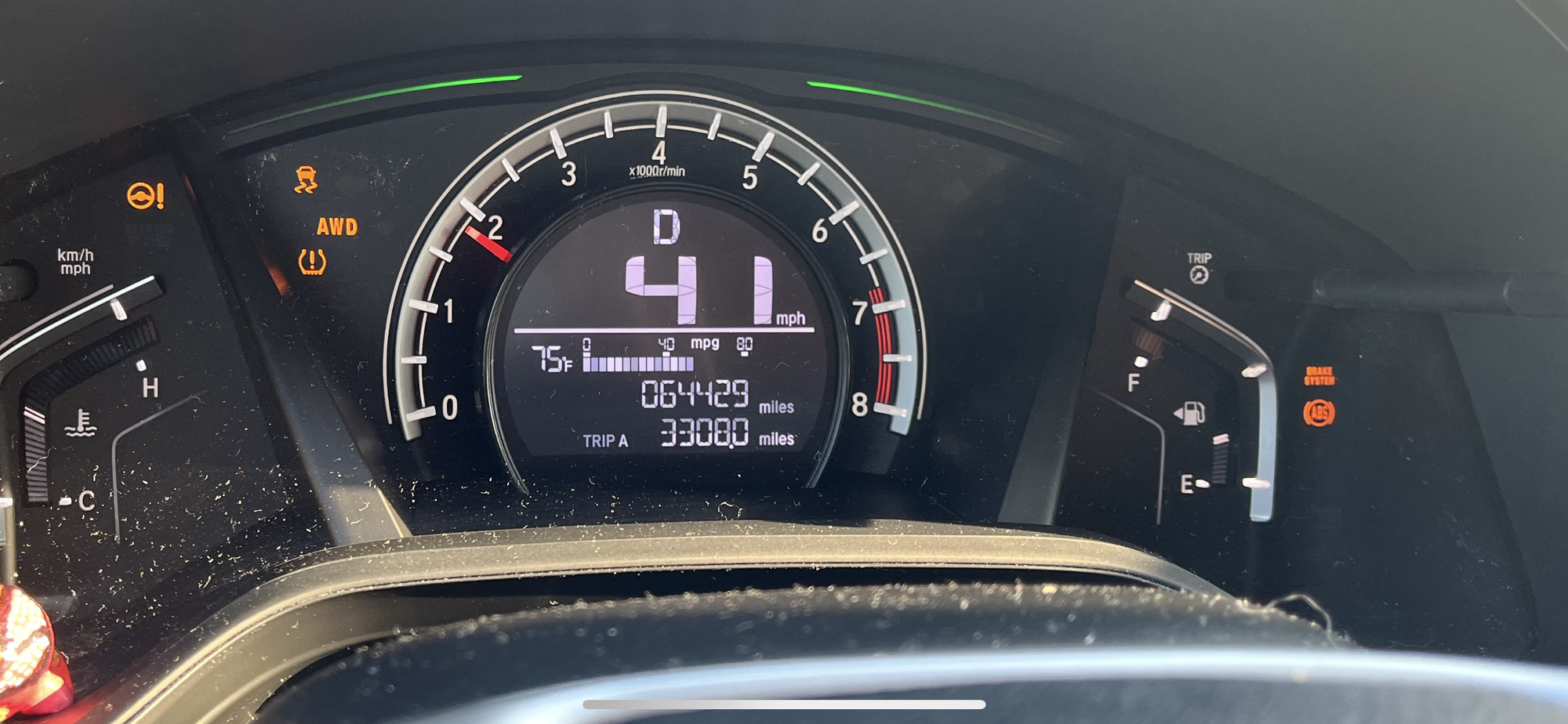

Need help with my 2017 CRV LX AWD.
had new rear breaks and rotors installed 2 weeks ago, and we went on vacation and drove about 900 miles on it. When we got home we got all these lights on the dash that come and go but stay on most of the time.
Had autozone scan it for codes, but there were none. Any ideas what’s going on? Seems to drive ok but the transmission seems to be quite jerky now as well, not sure if that’s what these lights are for. Appreciate any help

With no codes the multiple lights could be an indication of a battery about to fail. There is also a TSB for your model that related to battery parasitic drain that may be a factor in how you got to where you are.
https://www.tsbsearch.com/Honda/17-032

this is helpful, thank you. I have a apt with my mechanic scheduled so fingers crossed it’s just a battery replacement and nothing worse
Old Aug 7, 2024 | 08:52 AM
You need to scan the ABS module and find what wheel is having a problem.
