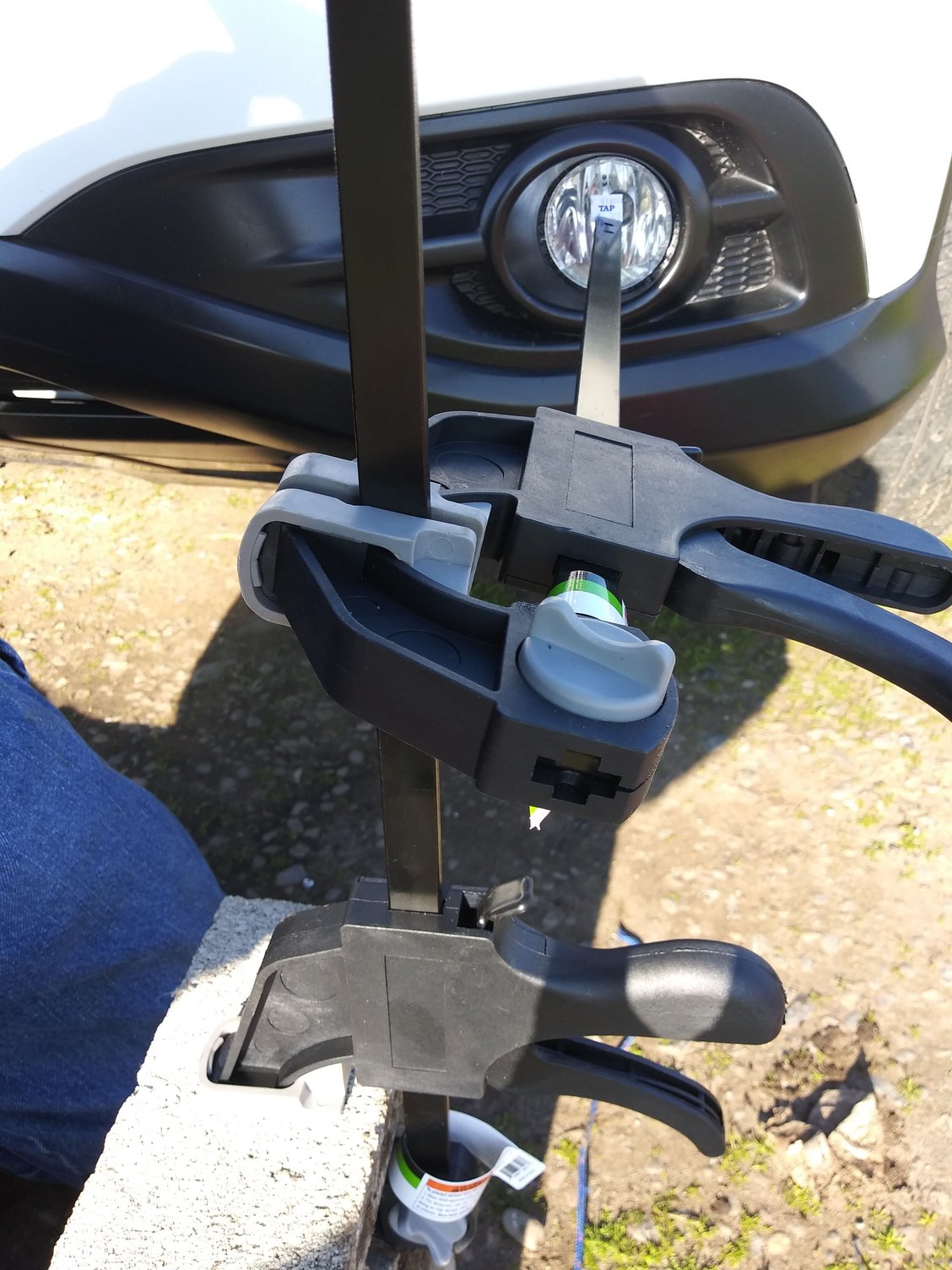

So, with the price of a replacement fixture from Honda (quan. 1) @ $211 and installation quoted by my mechanic ($180), I decided to go the cheap route (can you blame me??), even though I'd ordered cheap copies from eBay ($55). I went to Tap Plastics, and they had 3" clear discs precut, so I got one of those, plus some extra-strength glue. All for less than $10. The glue is setting now, as I type. Can I upload pics from my computer on this site?
Fog lite with broken lens
I'm still keeping the lamps I ordered, just in case. I may install them myself later on, down the road, so to speak.
Fog lite with clamps holding it in place.
