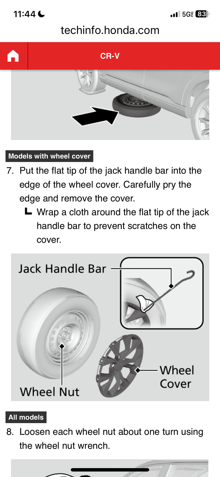

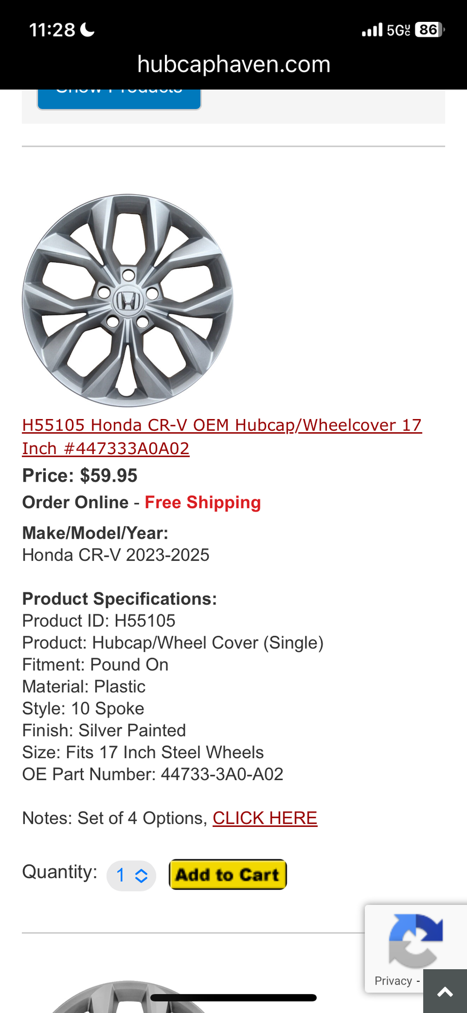

Did you try the suggestion to remove the hub caps, driving it and seeing if that definitely is the problem as Just Ducky suggested?
No. I asked the service reps about replacing them, but they said the hubcaps are fine and replacement won't be covered under warranty. When one of them disagreed about them being plastic hubcaps, I figured I'd better just figure out to remove a hubcap myself.
I've had multiple acquaintances outside of those two dealership service centers listen to the noise up close (not the video), and everyone believes the source of the noise is from the hubcaps.

Take them off. Noise gone?
I just meant for your own benefit try removing them to verify if they are indeed the issue. Not hard to pop them off Just carefully pry around the hubcap a little at a time moving around the hubcap as you do it. To put them back on just use a rubber mallet or double up a rag to protect the hubcap and use regular hammer. Some have just used the side of their fists if stout enough.

OK, now you know the wheel covers are plastic and how to get them off.
