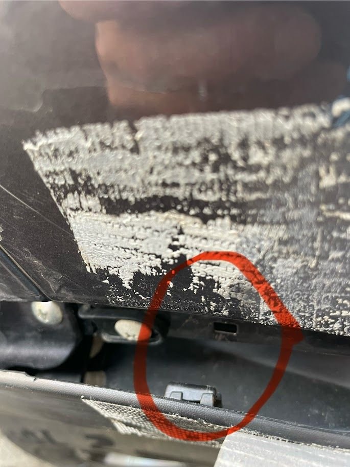

Hi guys, new to the forum here. I have a Honda CRV 2017
I had an unfortunate slow-mo run in with a steel post, and as a result, it broke the little attachment pieces that hold these plastic pieces together, above the front left wheel, (look at pictures, i'm not sure of the names of these). From the look of it, it looks like I would need 2 different types.
Would you know which attachment I need exactly, I tried a few bought at CarQuest, none worked.
Thank you

The parts highlighted in the photo are FL Fender, FL Fender Trim and FL Fender Liner.
https://a.co/d/8KhC7kF
In order to find the exact clips of un described location the model and build location would be needed for reference.
Soooo, rather than engage in dentistry, you can go to an online parts supplier like hondapartsnow or a dealer like collegehillshonda and enter the info needed to find the specific.
You will also need to identify the assembly then drill down to the subassembly where you can view a schematic.
On that schematic you will find a reference number for the clips. You can then go back to the parts listing and correlate that number to the needed part.
An online search of that part number will then point you towards sources for that part.
Happy Hunting

A collision shop will sell them to you.
