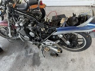

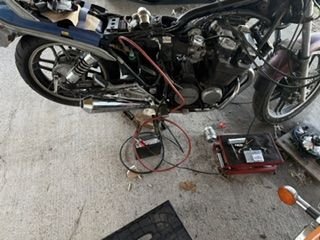

OK, it finally warmed up enough for my 70 year old butt to get out and work on the Nighthawk some more.I've opted for an aftermarket headlight, turn signals, and exhaust. The OEM exhaust was rusted through, but the headers were still good, so I cut them off at the ring just as they flare out from the headers. I got some slip-on aftermarket mufflers that work well, except they spread out too much, so I'll get a flex joint of some kind to pull them back in. I'm still working on adapting the wiring to the new headlight. I have the starting system working, making sparks when I push the starter button. I had an old V-Twin battery sitting around that still has maybe 80% capacity, so, when I saw the sparks, I put about 150cc of fuel into the line to the carbs, and sealed off the vacuum line. It actually started and ran for maybe 20 seconds! (I went through the carbs over the winter.) That's encouraging! Now I only have to do a couple of hundred little things to get it on the road!

After some head scratching, and some parts fitting, I've come up with a (temporary?) fix for the holy mufflers. I cut the mufflers off at the solid ring near the crossover. That was a bit of a pain, but with a 2.25" to 2" exhaust reducer, it let me put an aftermarket slip-on in place. The problem was there is a maybe 20 cm inner pipe that flares out from there, so the slip-ons stuck out too far. It looked weird and would likely drag in a sharp corner. So, I got a slip joint that gave me about 20 degrees of play that got the pipes back in line with the mounts. Unfortunately, that piece added several inches to the length, so the mount on the pipes sticks out from under the mount on the bike. It's solid, and it works, though it has a sort of steampunk vibe. I'll do something about that later, maybe. Anyway, I've verified that it'll run, even with an intermittant #1 plug wire. I just got a new set of coils and plug wires anyway.
