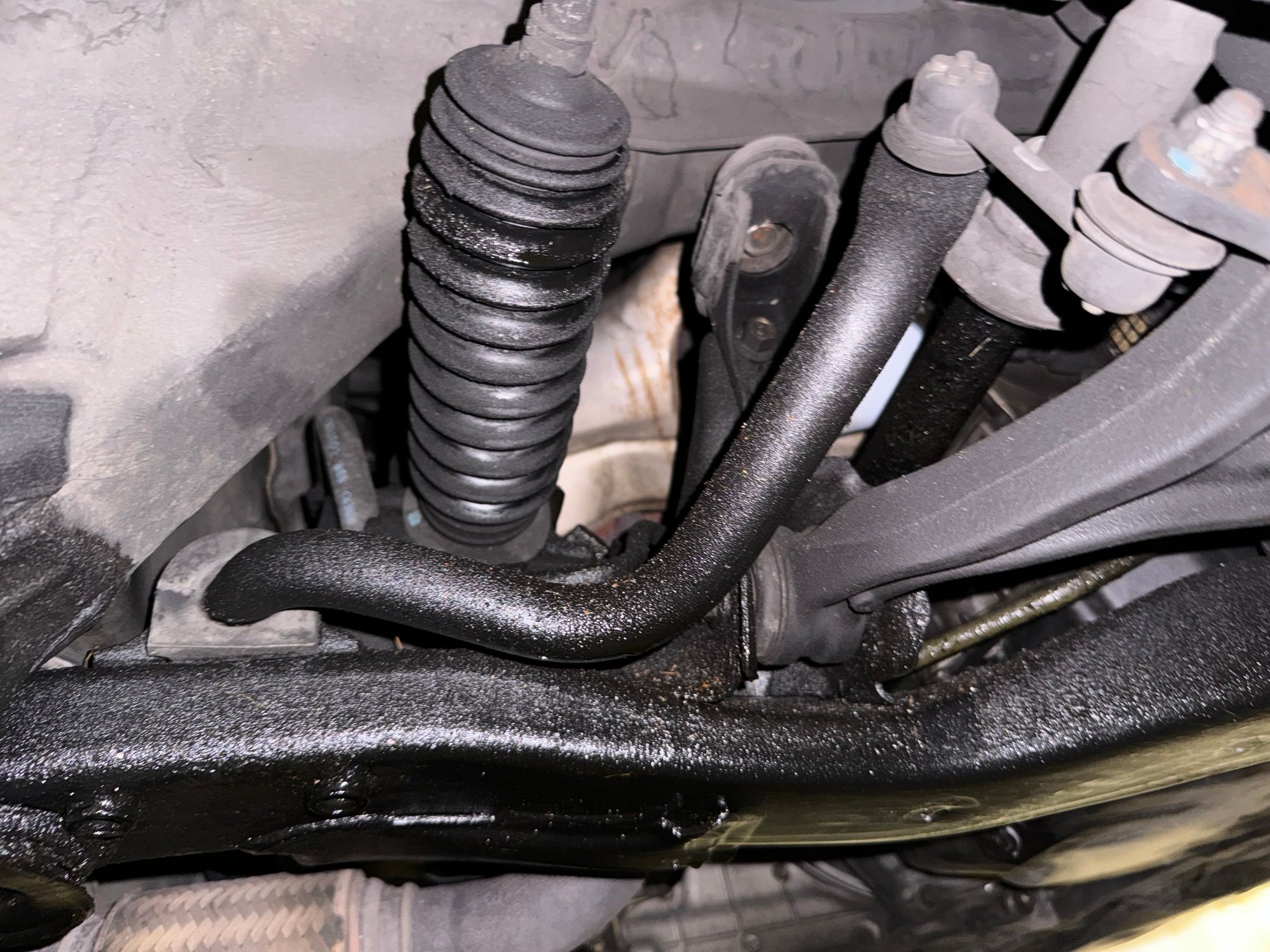

I noticed a puddle of some sort of fluid on the garage floor this morning. I took a look at the undercarriage, and it is completely soaked underneath the passenger side. Any leads as to what may be causing this?

possible rack and pinion. Is your power steering fluid going low.

Hey, I hope all is well. Thank you for your response. Yeah, I find myself having to top off PS fluid quite often. The rubber hoses connected to the PS reservoir are also damp.
