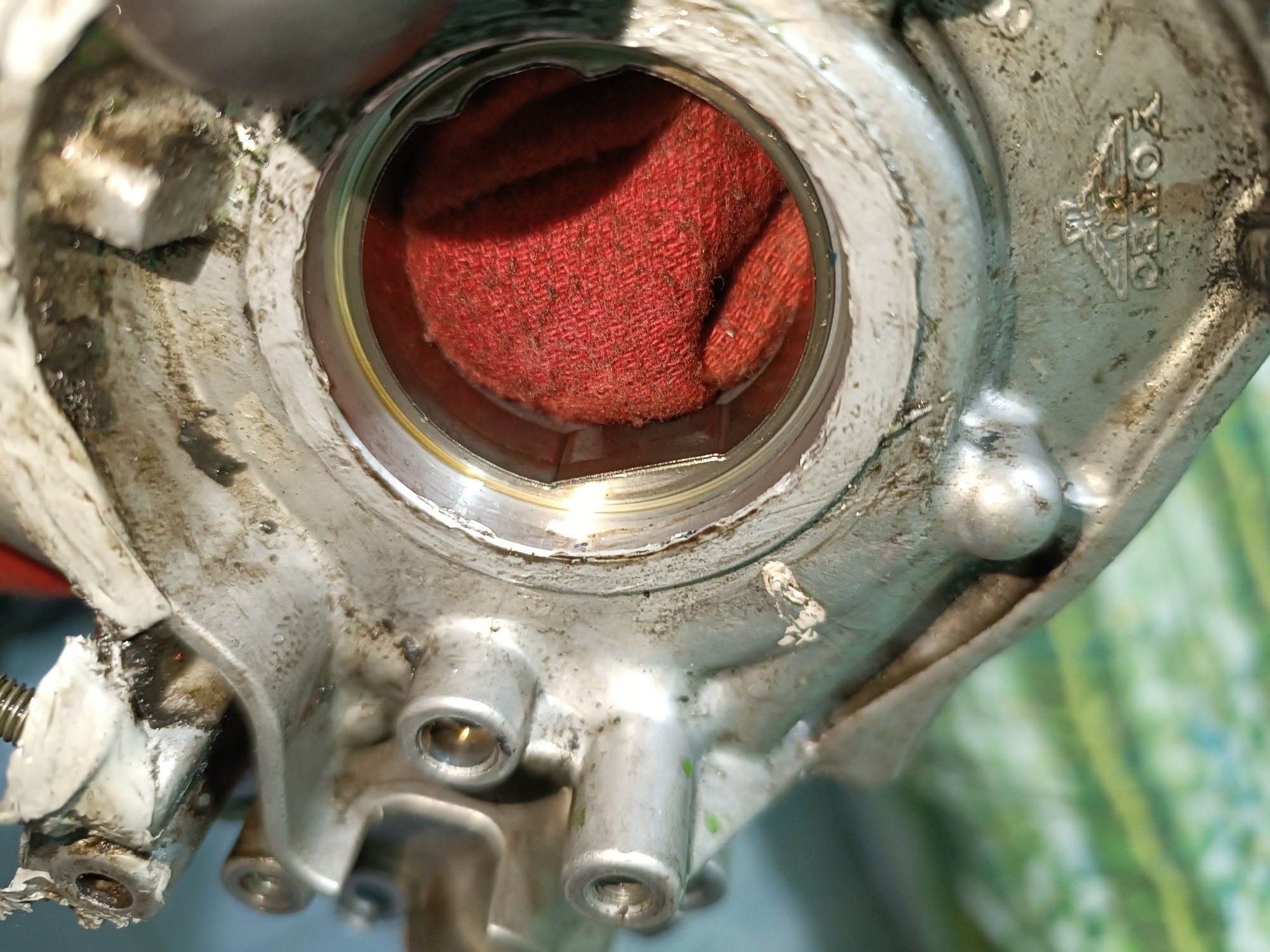

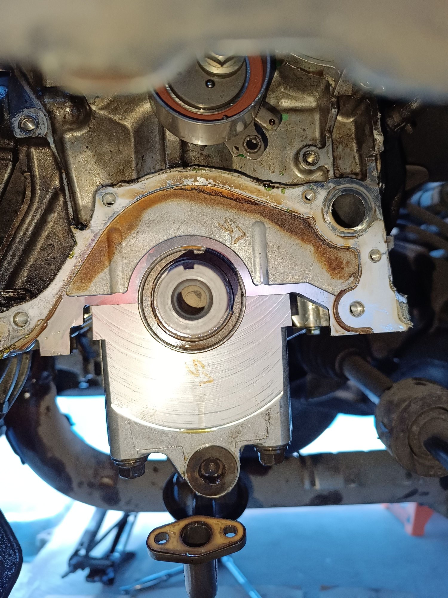

The car (civic 2003 LX 1.7L) was leaking oil. I replace the valve cover gasket and noticed that there was still a leak. So tracing the problem I figured that the O-ring on the oil pump was leaking.
Well I've taken apart both and I was wondering if it was ok to reuse them and reseal everything or should I buy new ones. The car has 280 000 km.
The car was never touched by anyone other than the dealership (the car was bought from the dealership in 2002) and as I was taking everything apart I noticed that everything was covered in Honda bound. The camshaft and crankshaft seals had Honda bound on top of them and it looked like there was so much of that that a leak created a bubble of oil right next to the oil ring part of the oil pump. Also I noticed that the outer side of the seal part for the oil pump was scratched and that made me wonder if I should change it. I include some photos of reference and I would appreciate any suggestions.

Here is how it looked liked at first (you can see the oil bubble there), this made me think the problem was in the seal of the oil pump.
HEre is where I see the scratch marks, probably when years ago the dealership changed the seals. They seem to be only on the outer side away from where the seal sits, but I wonder if they are bad enough to change the oil pump completely.
In these last 2 picture you can see that both cam and crankshaft seals are covered with Honda bound.
from my understanding that is not necessary.

Never reuse seals.
A dealer did that goop job? Was that their attempt to fix something?

Old Mar 4, 2024 | 07:42 AM
Originally Posted by Estebanego
What I wasn't sure was if it was necessary to buy a new oil and water pumps or just replace all old seals with the fel pro new ones.
Judgement call.I would replace them if it were me.
