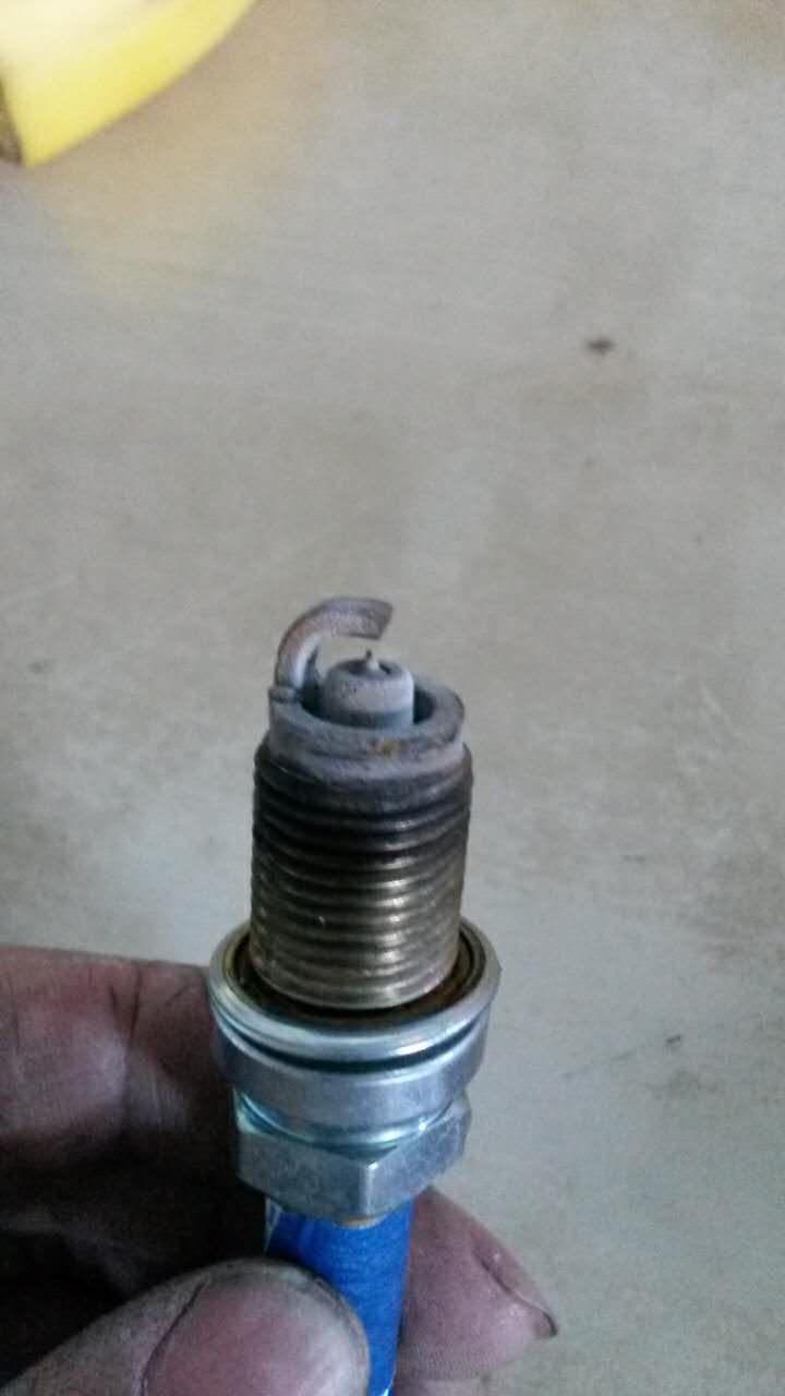

just did the spark plug change on my 2002 honda crv (just took up interest in car maintenance), does this old spark plug look normal or does it look like running lean ? (all four plugs look the same.) Thanks.
I tried scraping the electrode, not much ash coming off though, just a tiny bit of microscopic-size dust looking thing came off.
Attached Thumbnails does this spark plug look normal to you?-1.pic.jpg   does this spark plug look normal to you?-2.pic.jpg

welcome to the forum. plug looks normal. usually the plugs will last 100k. they are irridium plugs.
Old May 5, 2016 | 06:07 PM
Normal carbon trace

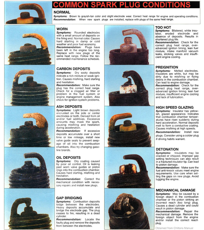

looks normal to me.
Attached Thumbnails does this spark plug look normal to you?-sparkpchart.jpg
