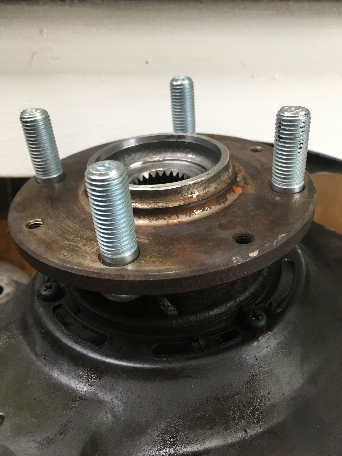

Moved to the passenger side, the one I had to use the puller on... the axle spindle won't go into the old hub... its too borked (dammit!).
Going to have to purchase a new passenger side axle and the correct hub... so the question.. Which freaking hub is the correct one to get for a 1982 Honda Accord LX?

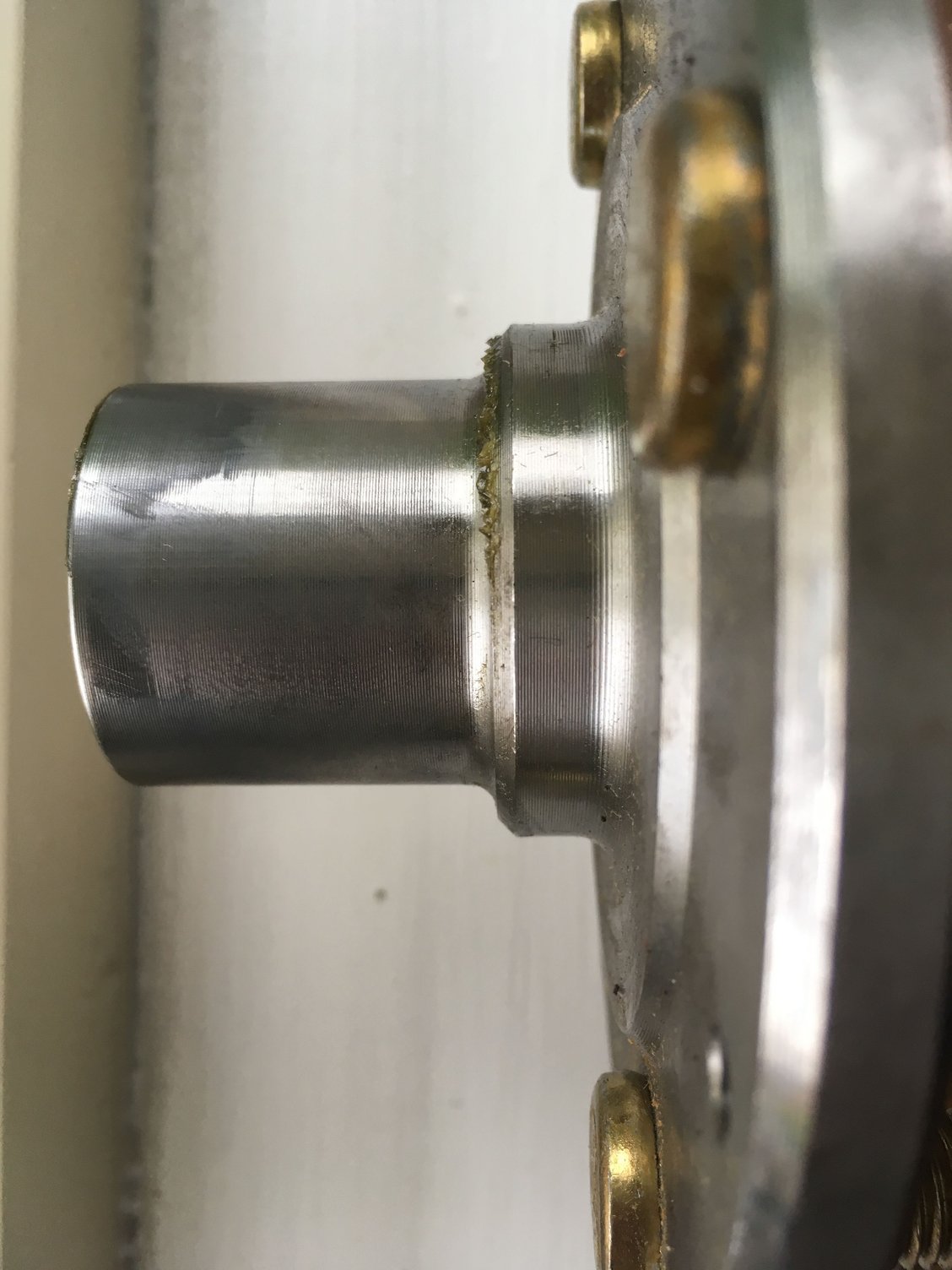

The correct hub was this one:

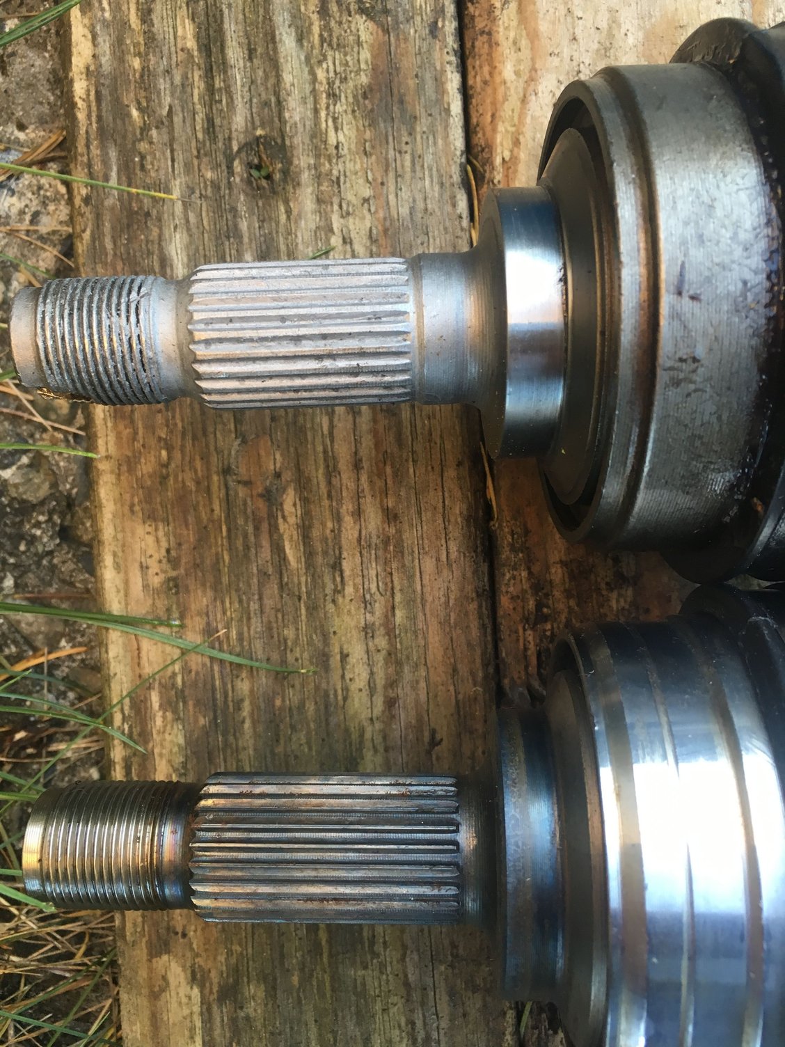

The splines on the new axle were longer, but it the hub just fine:

Interesting, I didn't notice that before. Wonder if the "NT" in front of the correct one means anything. I wish I would have taken a picture of the two side-by-side. The CV-facing shoulder was a good 1/16th - 1/8th inch higher.
