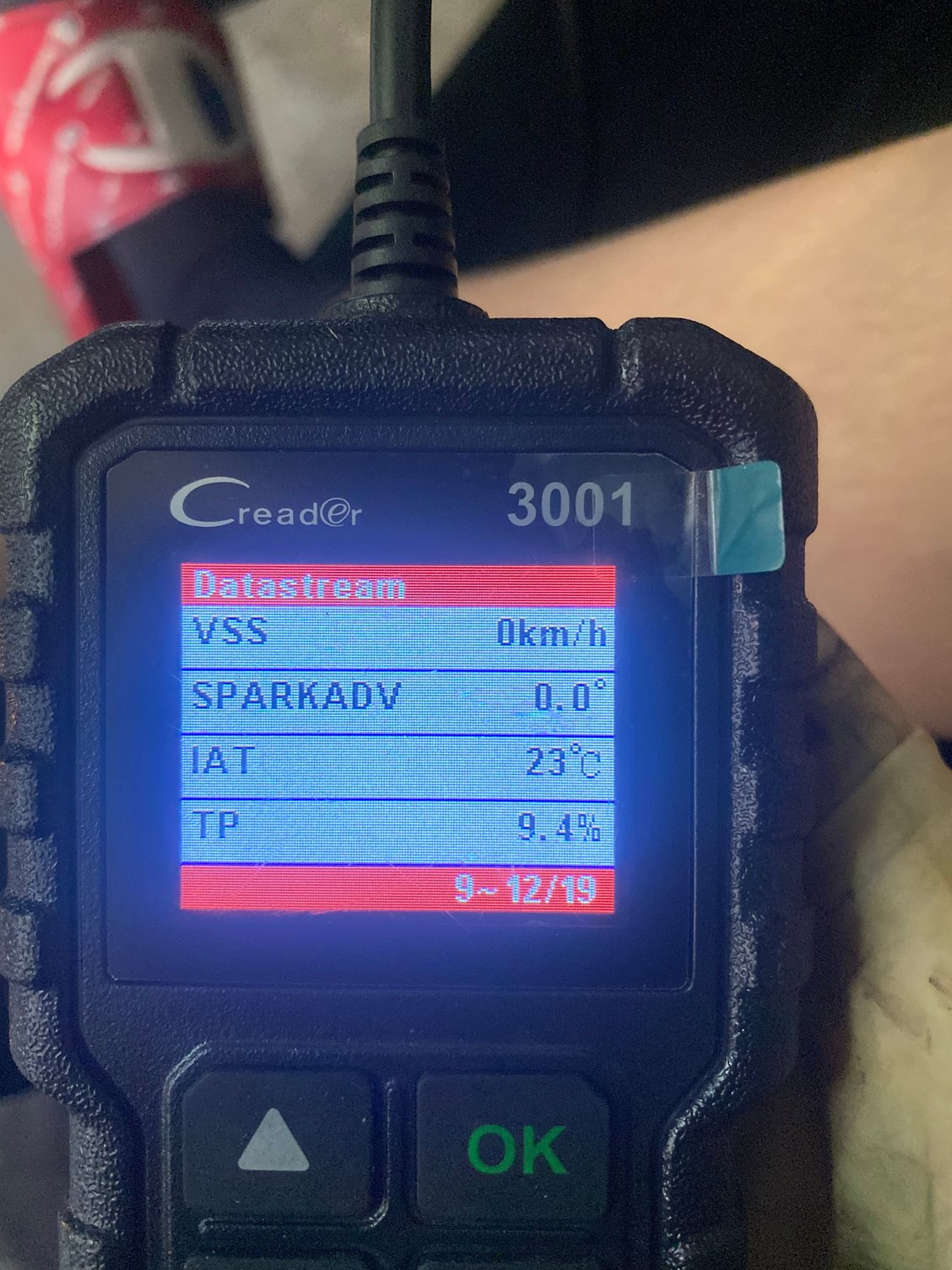

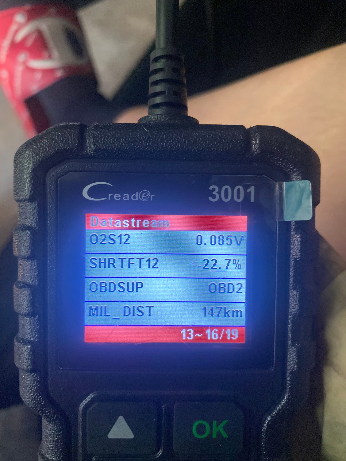

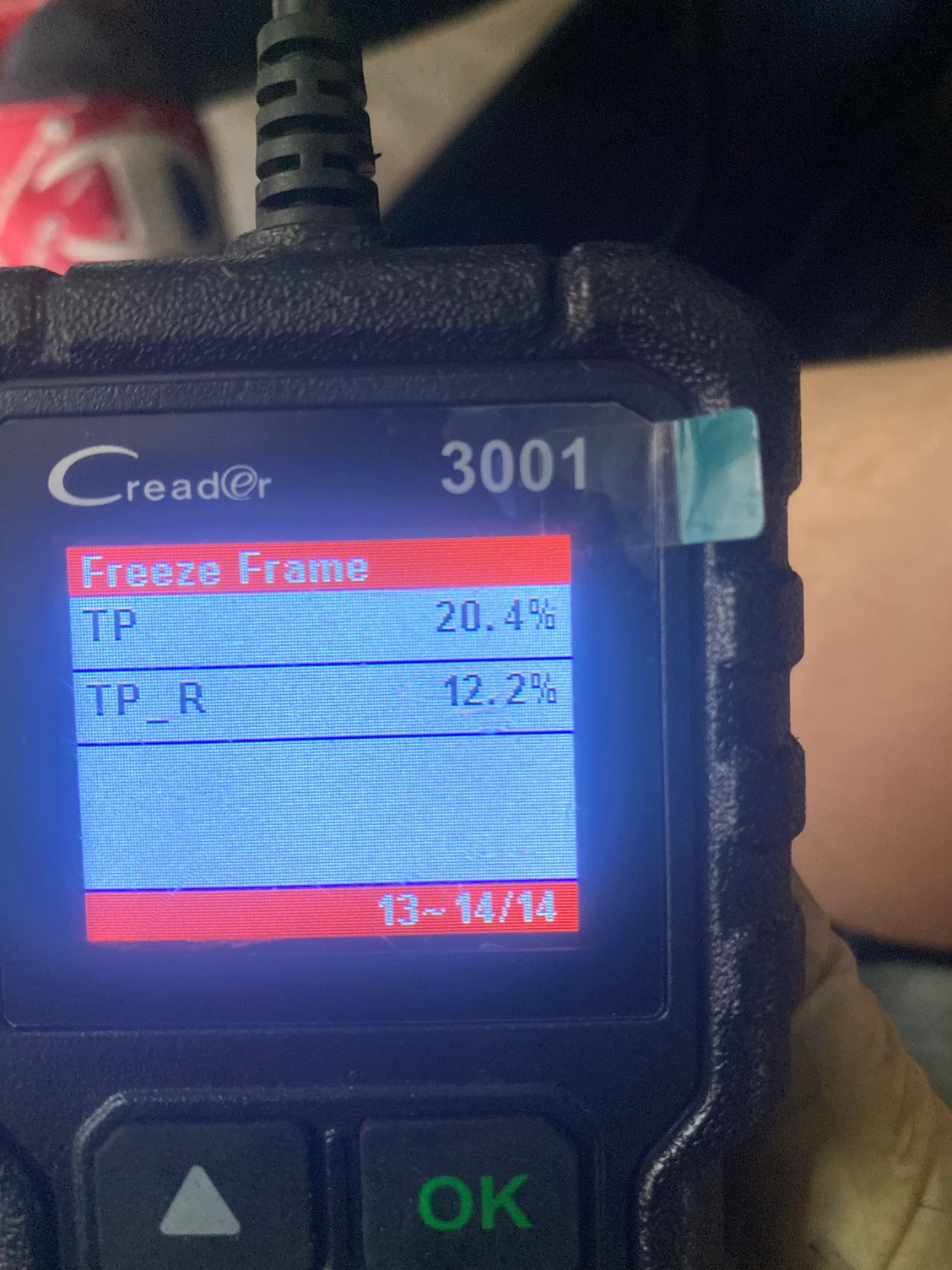

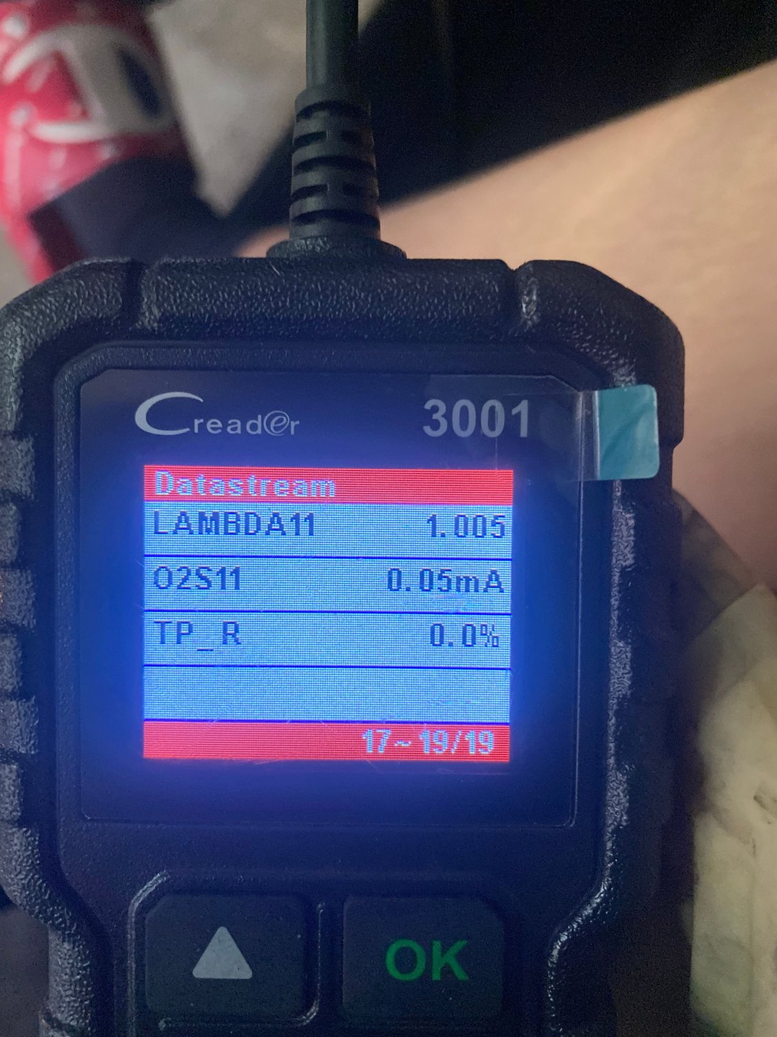

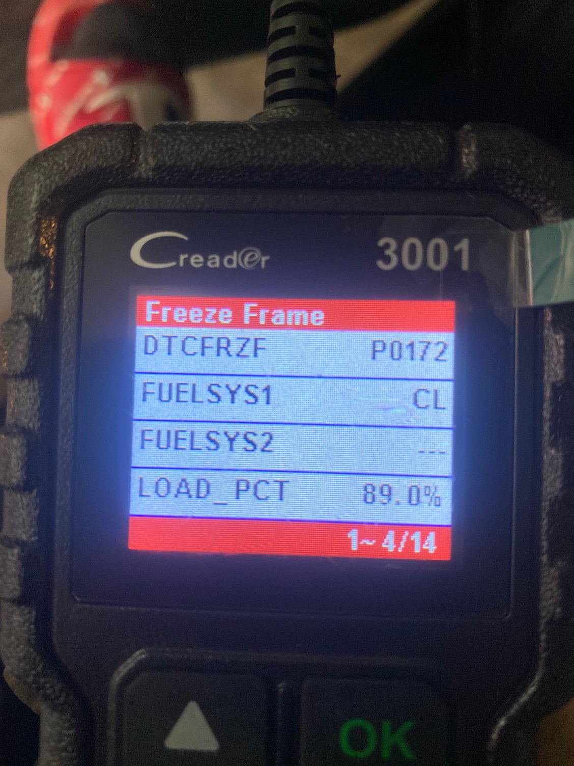

So a little background: the car was running a little rough and threw the code for bank 1 sensor 2. So had the downstream o2 sensor replaced. CEL was cleared, drove about 20 miles and got P0172 and it started driving really rough. Low acceleration, almost stalling, gas smell.

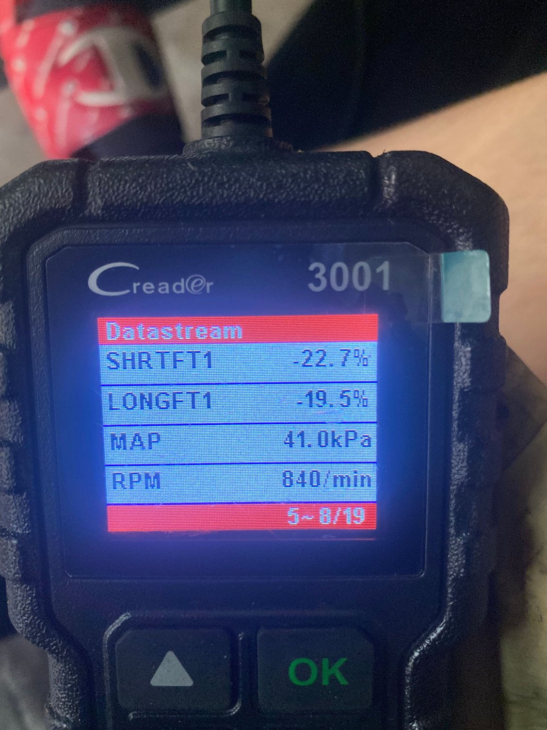

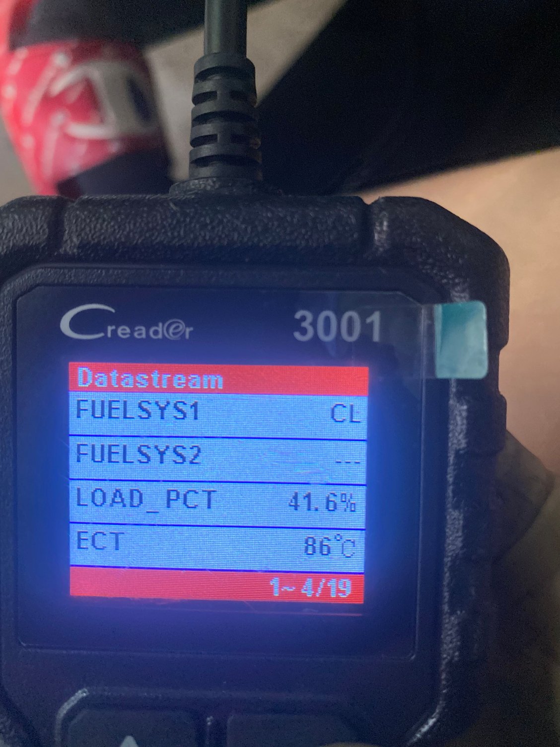

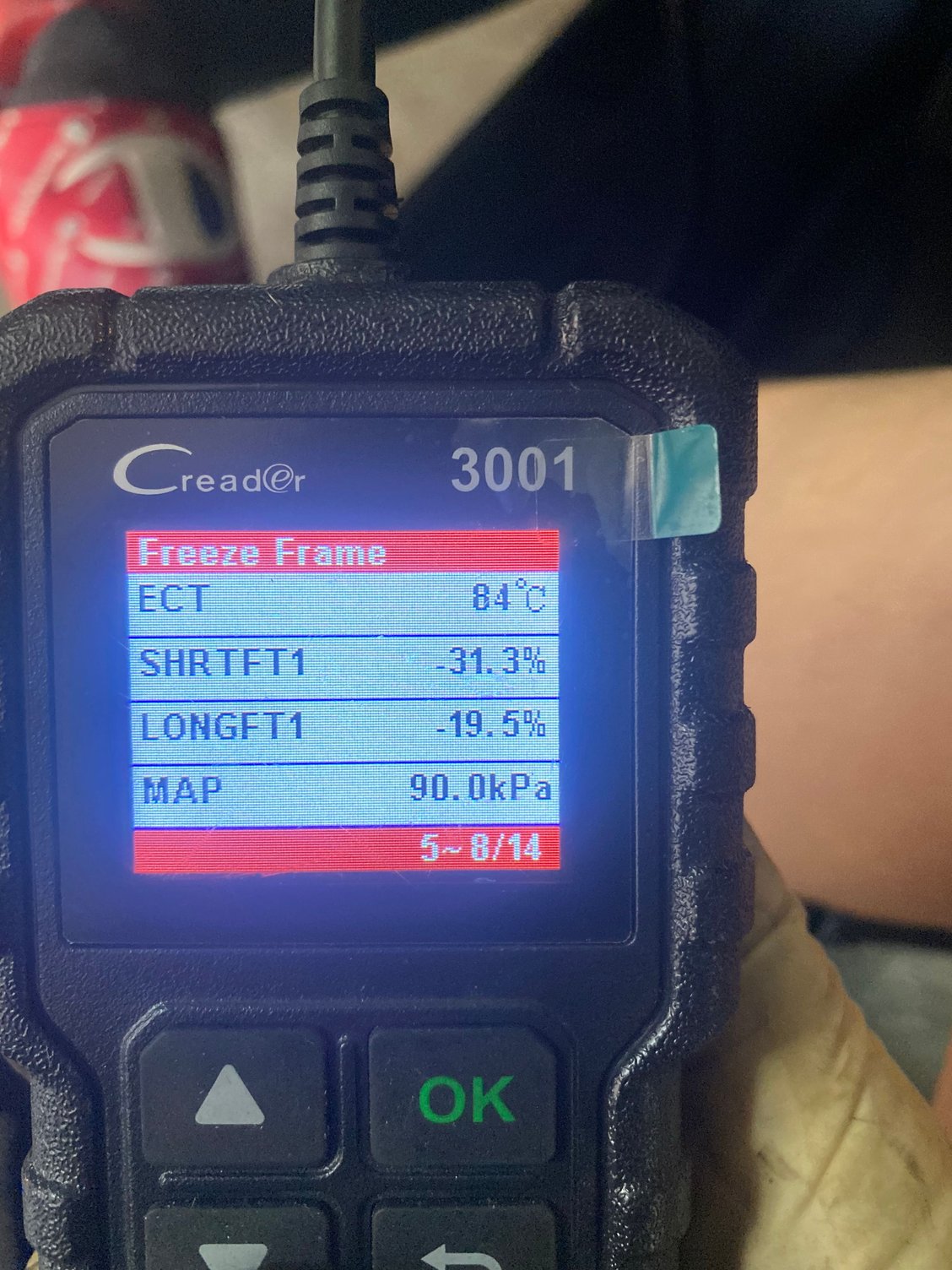

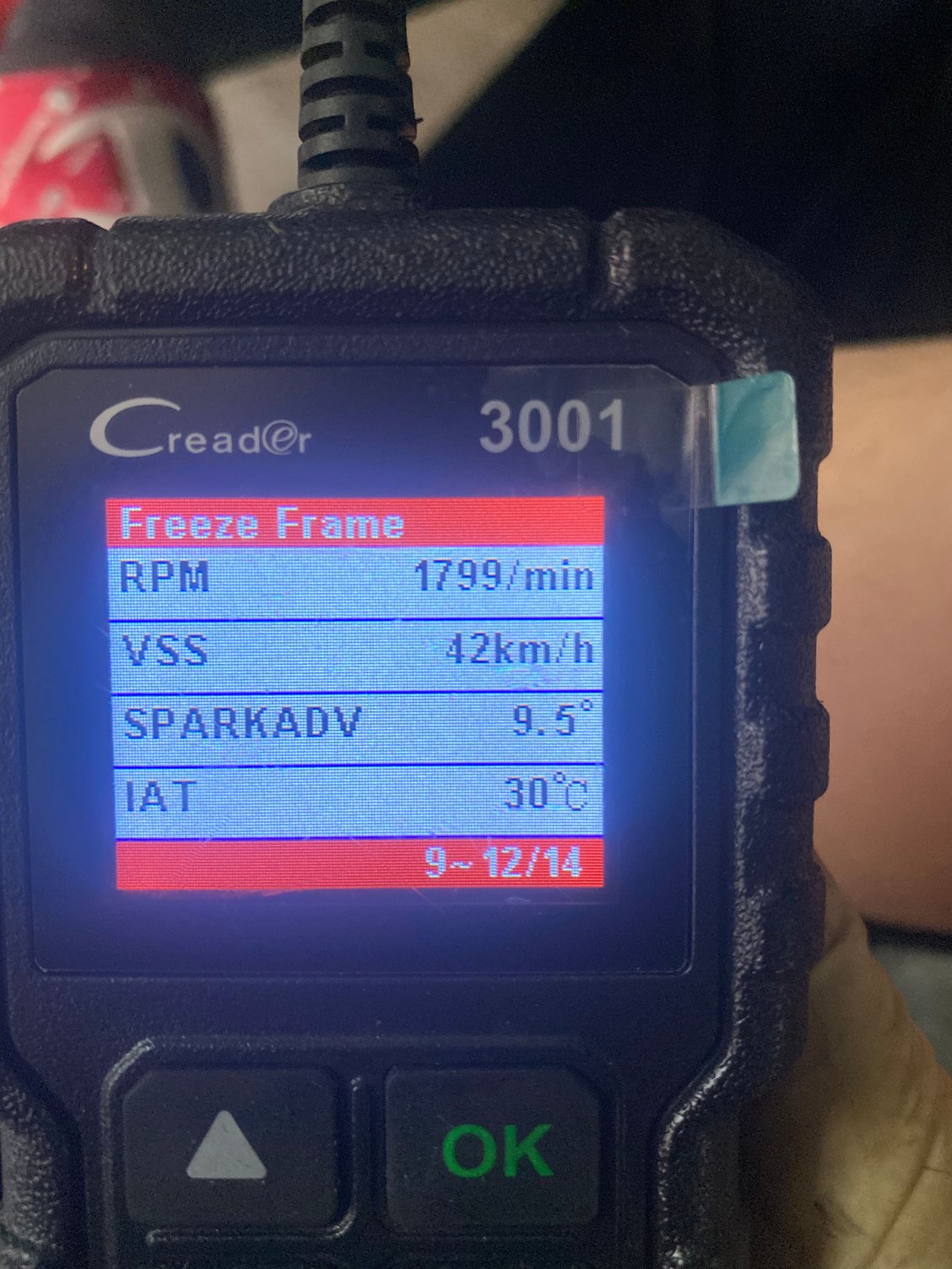

Since then I’ve only replaced the EGR valve and air filter, and cleaned the MAP sensor (no MAF sensor on this model) with no change. So now wondering if the MAP sensor is faulty, do I need to replace the upstream sensor, or is this related to spark plugs or fuel injectors? I don’t see any tears in air hoses either. Here is the freeze frame data I took
Old Apr 23, 2022 | 01:52 PM
It's running rich. Check fuel pressure. You do not clean MAP sensors.

Seeing the load is at better than 40% at idle I would think it a good measure to replace the map.
What determines load is Engine Speed (RPM), TPS throttle and air. Without a MAF the map plays a big factor in calculating load and how much fuel to add.
Engine speed is just off idle at 840 and throttle is closed so map is suspect. 40 kpa is twice atmosphere.

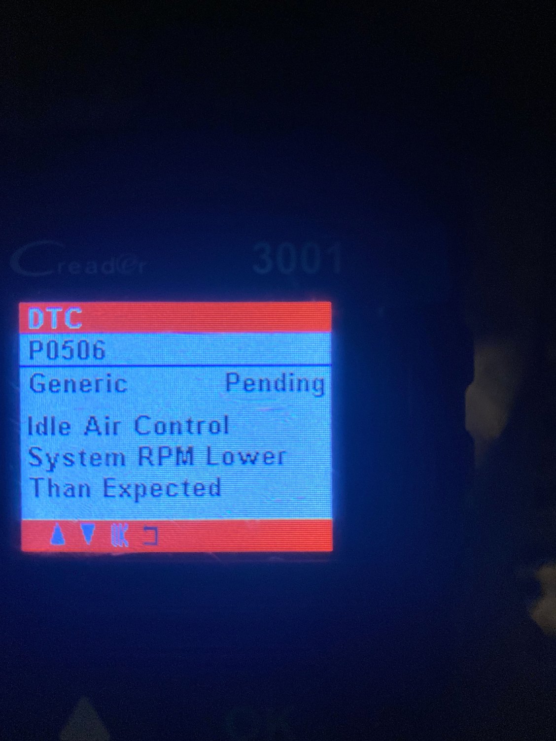

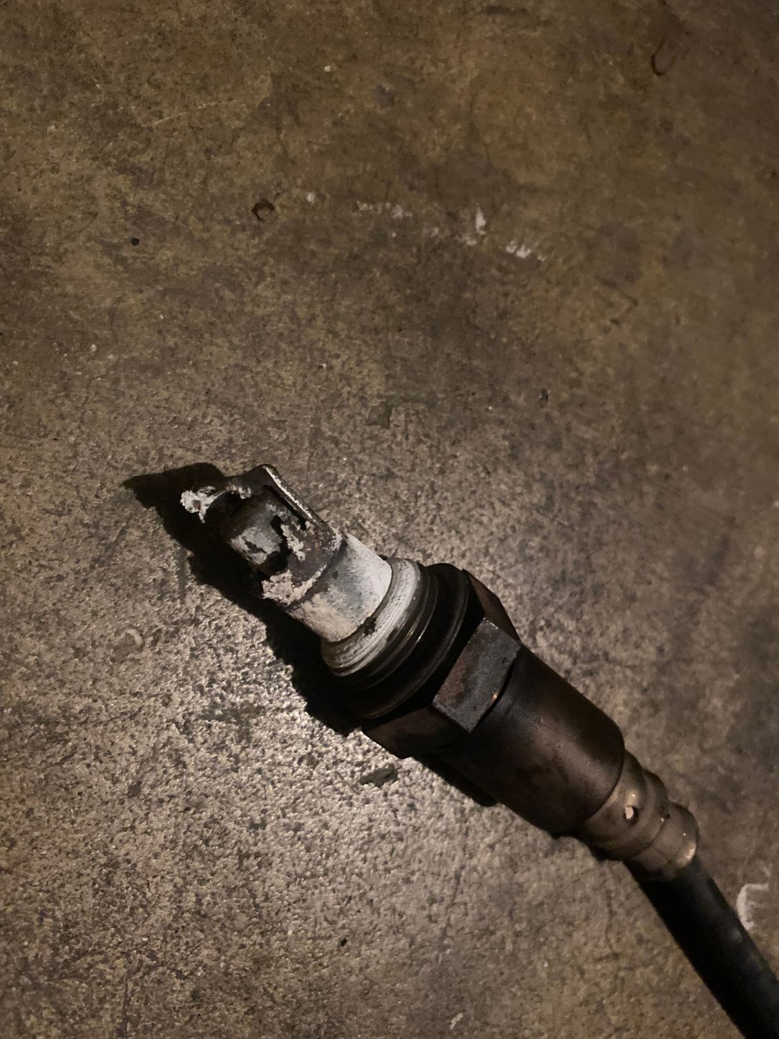

So I got the oxygen sensor replaced (turns out it was broken- see the photo). Also replaced the MAP sensor. Car driving has not improved and now I get a P0506. Any ideas?
Old Apr 24, 2022 | 12:28 AM
Did you replace the A/F O2 sensor (upstream O2 sensor) with an OEM or aftermarket??
Map sensor not indicated at first. If you kept the old one try putting that one back in and see if it gets any better??
Can also try cleaning the IAC, throttle plate and throttle body to see if that helps??
