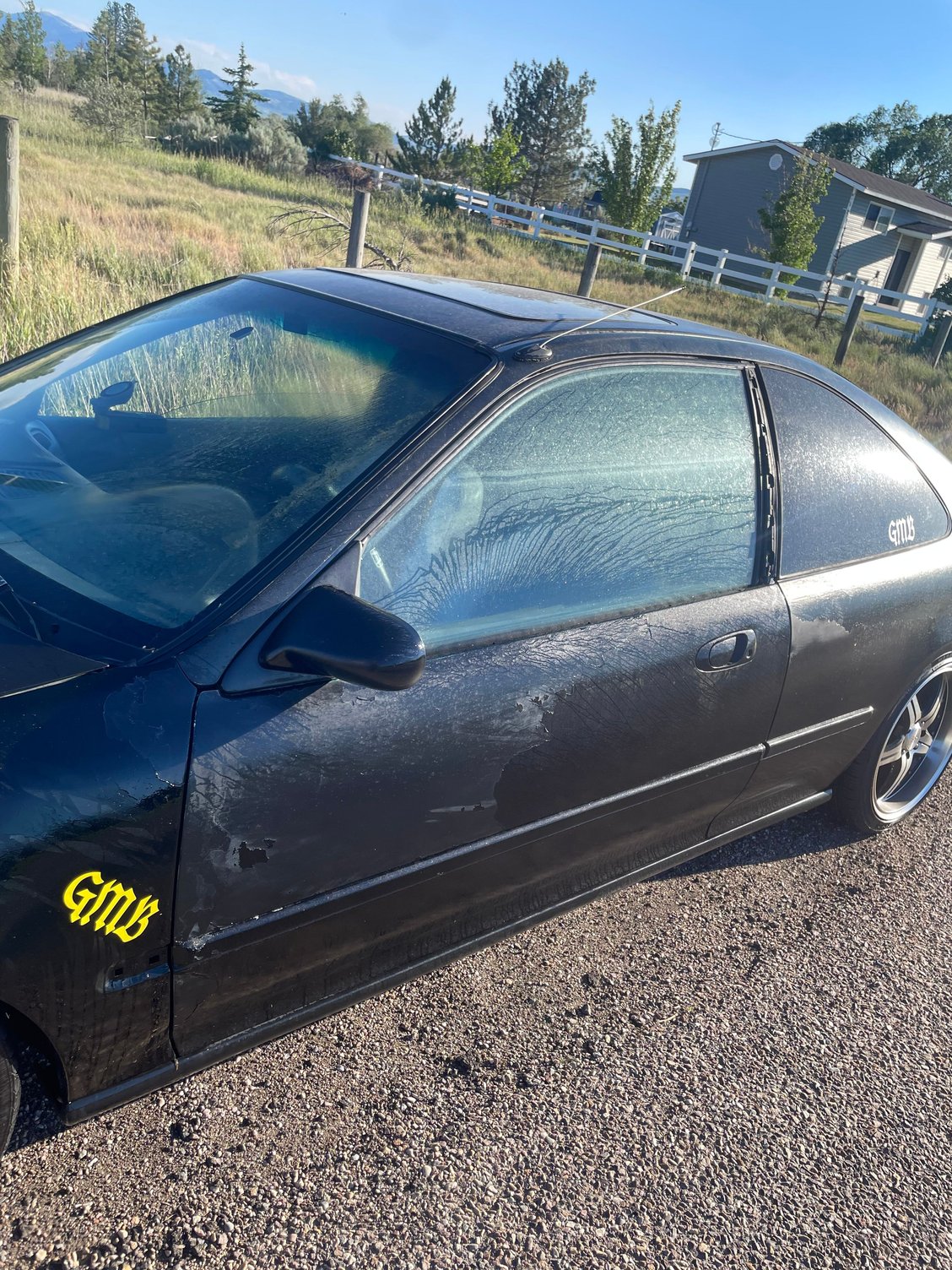

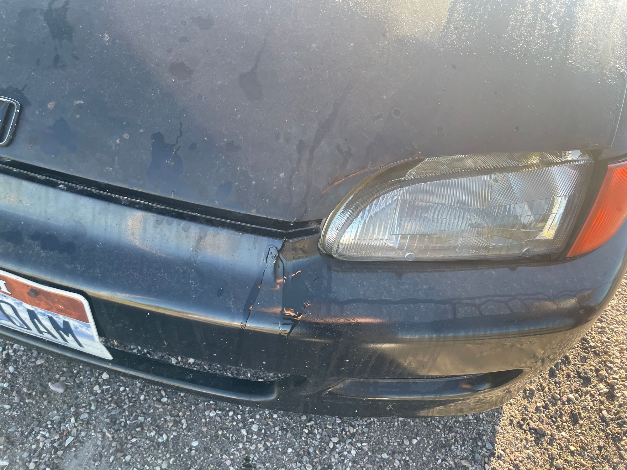

I had bought a car yesterday, drove it about 200 miles knowing there was a small oil leak, turns out while driving it got a lot worse. My windshield driver side window, and the whole driver side of the engine bay was caked in oil and i had to fill up about 2.5 quarts. It drips from the front when it’s stopped, but is likely coming from somewhere else. The guy i bought it from said he replaced all gaskets, but where should i look?? I can show pictures if could help. Car seems to run decent other than that, and a kinda bad idle though. No timing cover on the top and the belt is a little bit tight.
