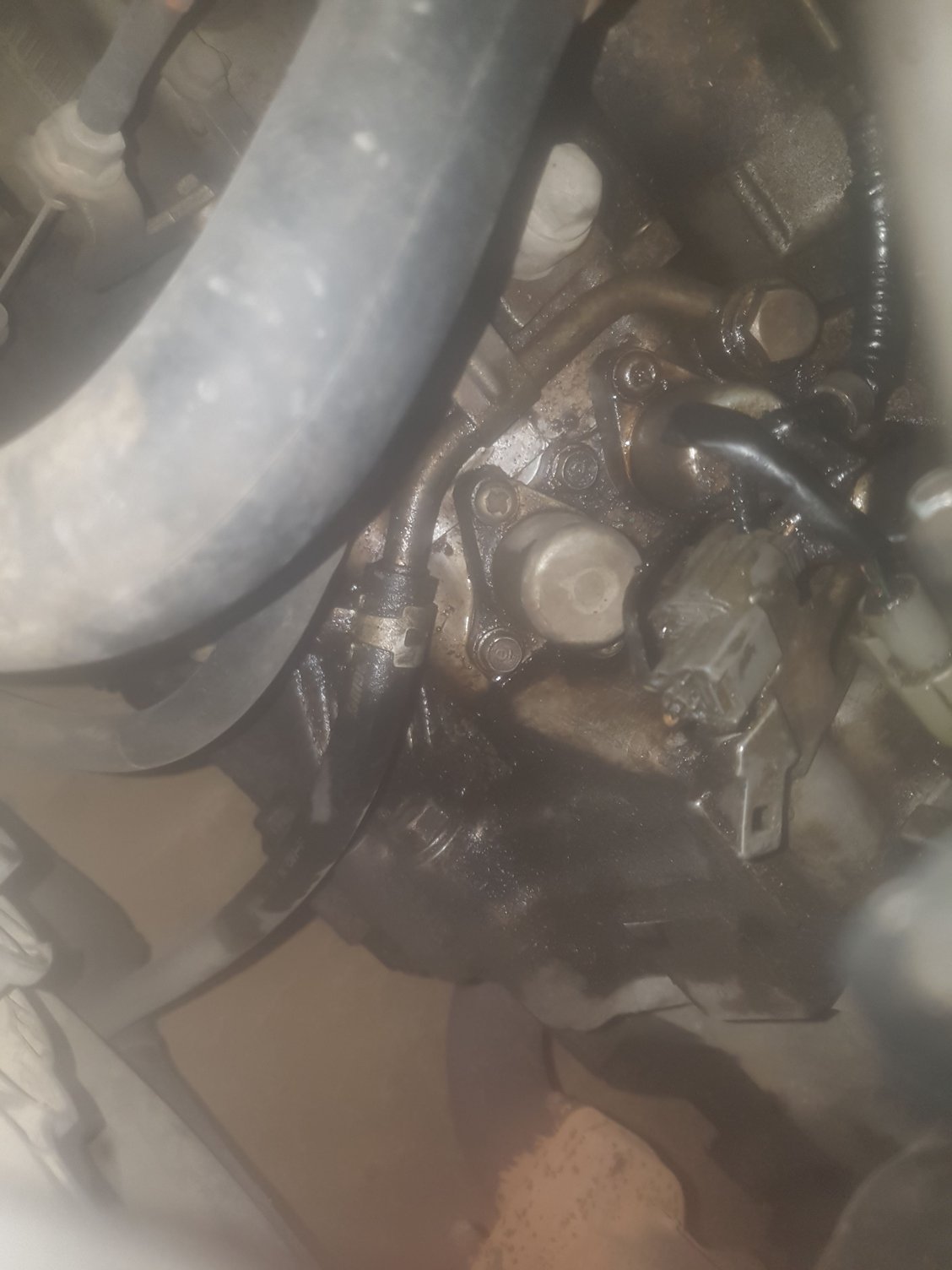

I did check the fluid it is clean. I do think it is the solenoid but the problem is there is only one solenoid i see on this tranny, i think it is the control lockup solenoid, i cant find info anywhere about this particular transmission(s4pa). I'm not sure if that salenoid is the lockup solenoid or control shift solenoid. Thats the only solenoid i can see

This is the only solenoid i could find

sorry that picture does not look like the transmission shift solenoid. the solenoid has 2 towers with 3 bolts holding the unit down.
