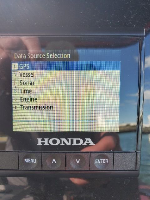

New installation
Honda BF150 iST
Honda HD-4 display
Garmin GPS MAP 943xsv
Garmin GFL-10 NMEA 2000 interface
issue as follows - GFL-10 is visible on network of both Garmin GPS MAP and HD-4. Fuel level function working on GPS MAP. I am able to disable the Fuel Data Manager on the HD-4, so to set up the fuel level bar on the 2x2 bars grid (with RPM), but the Fuel Tank option is not available on the list.
Any help appreciated. Thank you.
