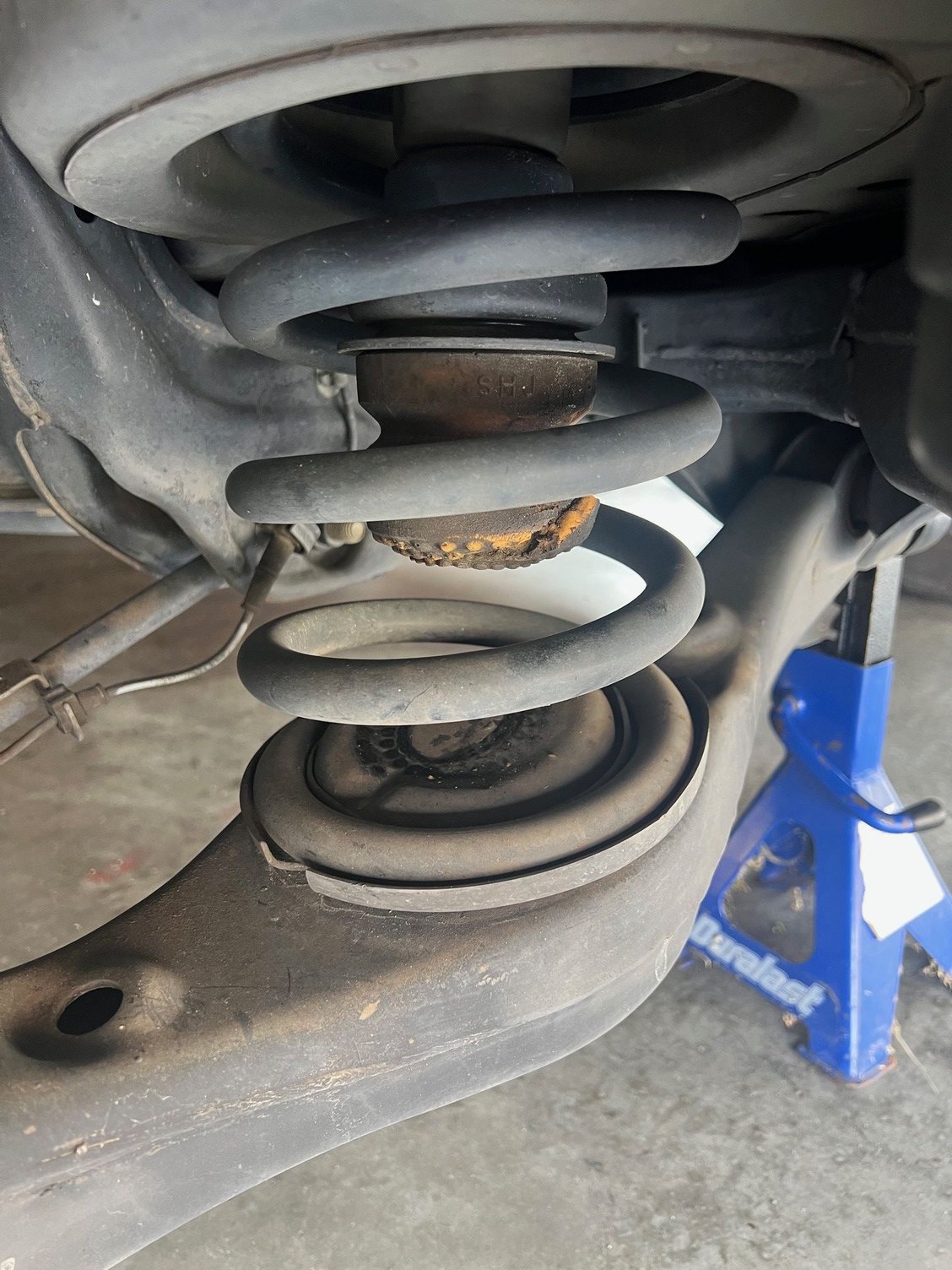

Hi,
Does anyone know what this piece is called and if there's a video on YouTube on how to replace it? I was replacing my rear brake pads yesterday and noticed it. Brought the car into Honda for an oil change last week and they never mentioned anything about it. It's a 2015 Honda Odyssey.
Thanks All!!
Old Mar 10, 2025 | 12:59 PM
Just Ducky's Avatar
Posts: 285
aka Rubber baby buggy bumper 🤣
https://honda.oempartsonline.com/oem...a03?origin=pla
The part is simple. The cause of it being “mushed” is problematic.
Weak spring, overloaded vehicle, jumping over speed bumps or getting airborne are likely suspects.
