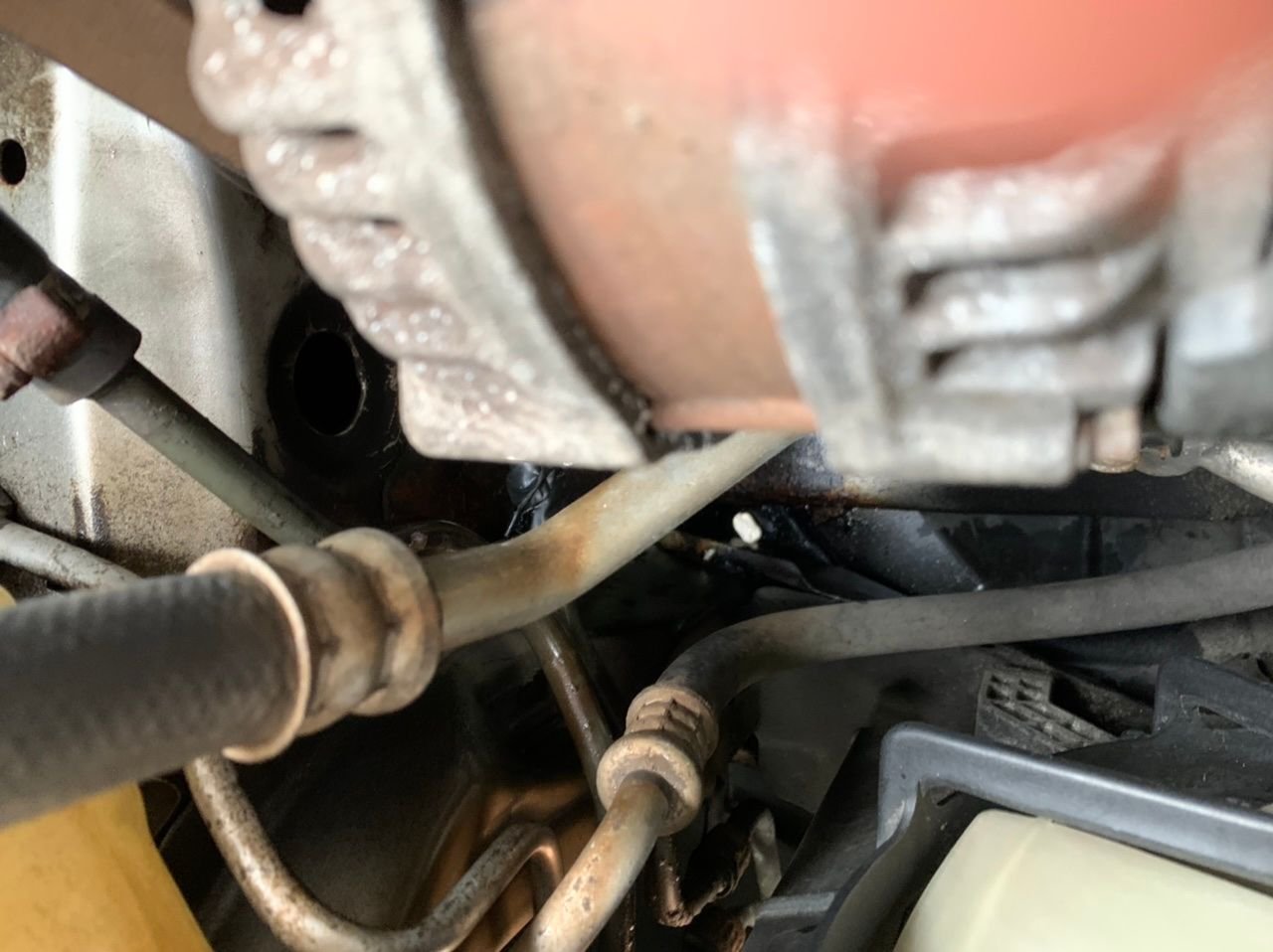

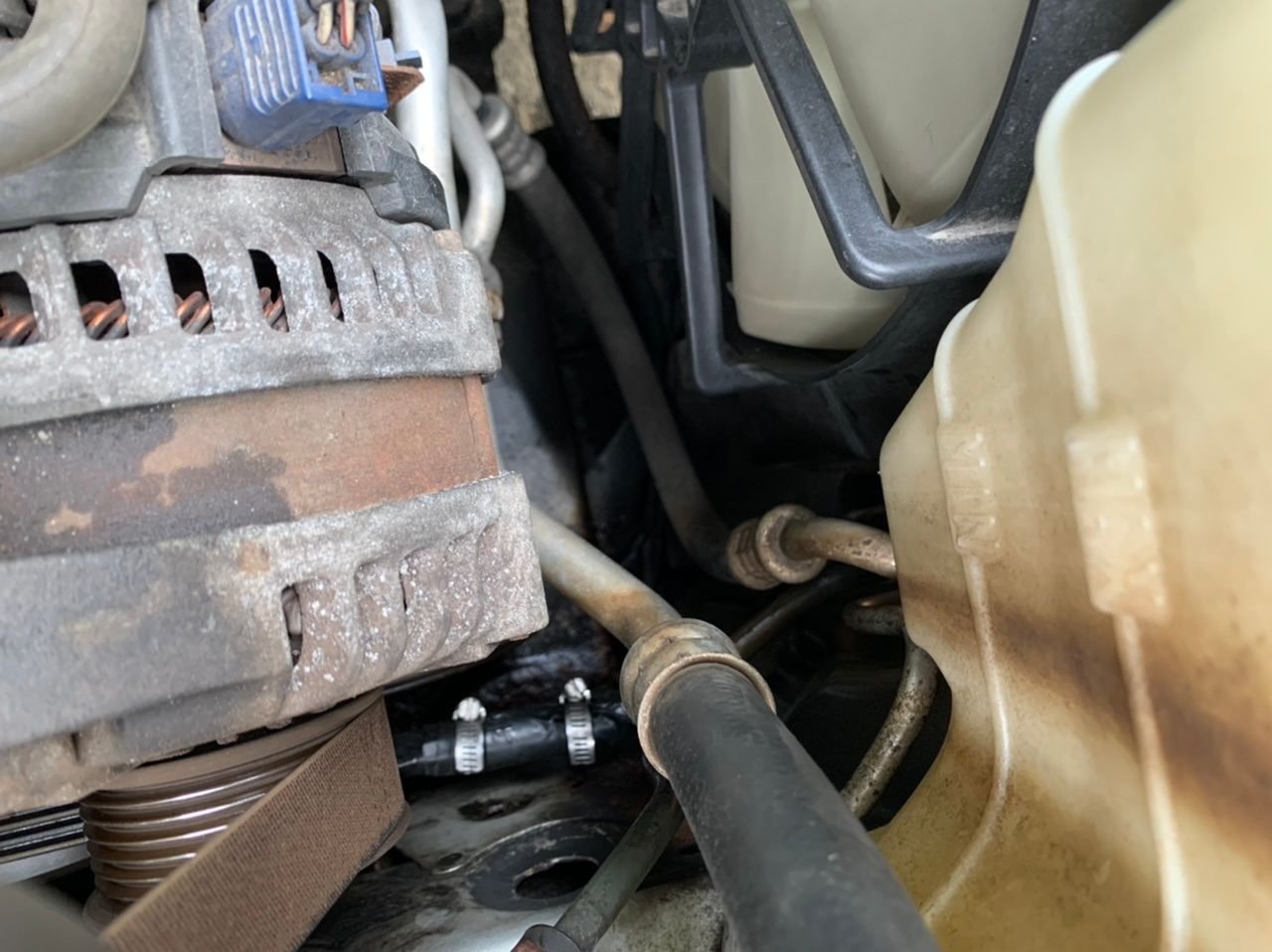

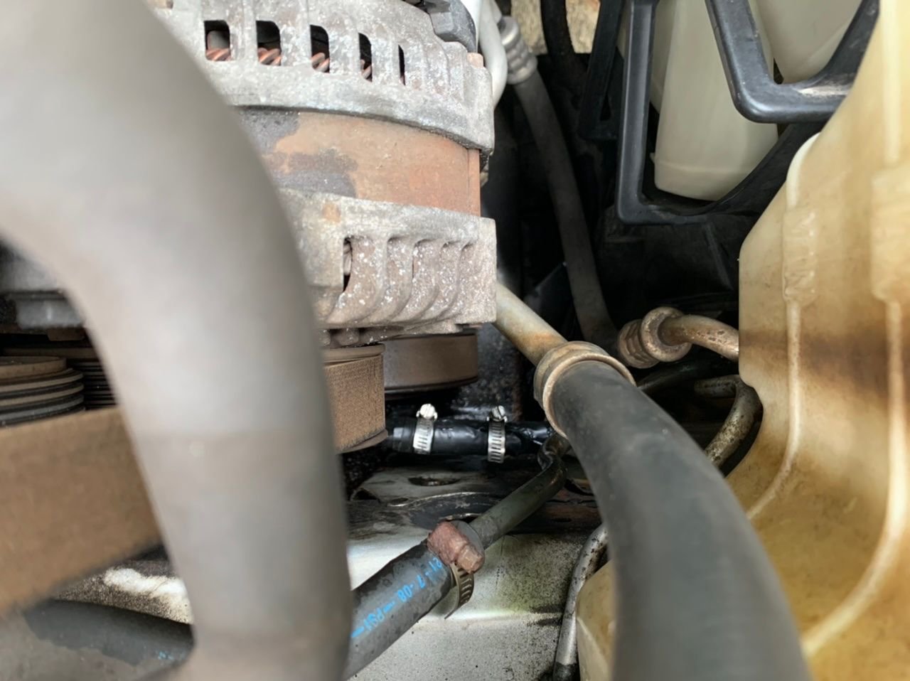

Hi guys so. My power steering was making a really bad whining noise and realized my power steering fluid was low so I figured just fill it up and it’s good well no. 1 hour later it was empty again. I found a leak it’s on a metal line towards the bottom. I called autozone and they said there is a low pressure line and a return line but I’m not sure which one it is! I took pictures I hope you guys can make it out it’s a
2008 HONDA ACCORD EX 4CYL AUTOMATIC

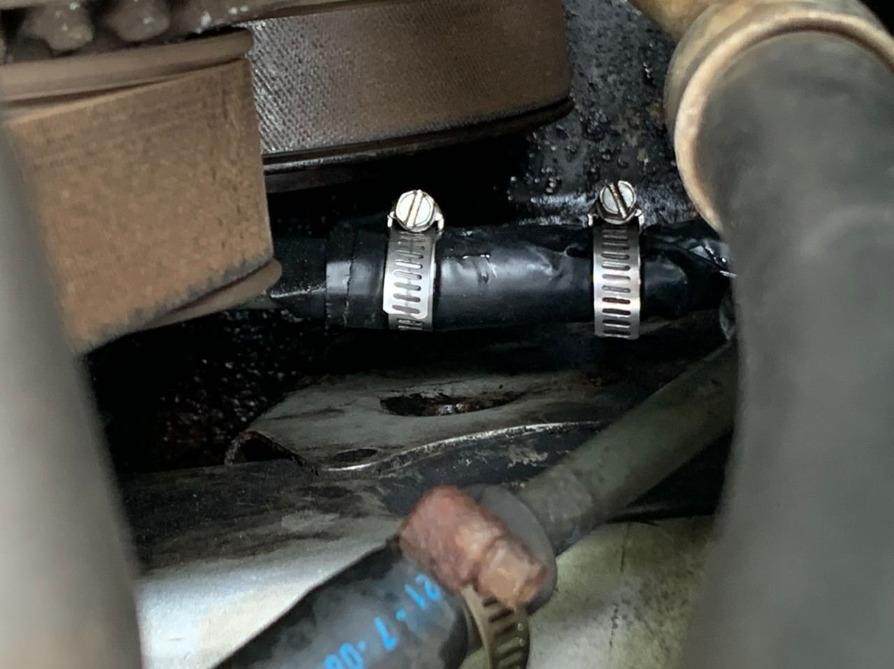

so as you can see in these photos I jimmy rigged it but let’s be honest it only held for 2 hours lol. That’s where the issue is there’s a pinhole in the metal piping. Return line or low pressure don’t want to buy the wrong one thank you!!
Old Jul 16, 2020 | 10:27 PM
Can not see where the hose goes from or to.
You should be able to talk with the guys at the auto parts store and ask questions
At least they can go to the car and see which hose it may be.
Old Jul 19, 2020 | 08:56 PM
i would almost guess that it may be the high pressure line, the low pressure line is the return line to the can, pressure line drives the steering actuator.
