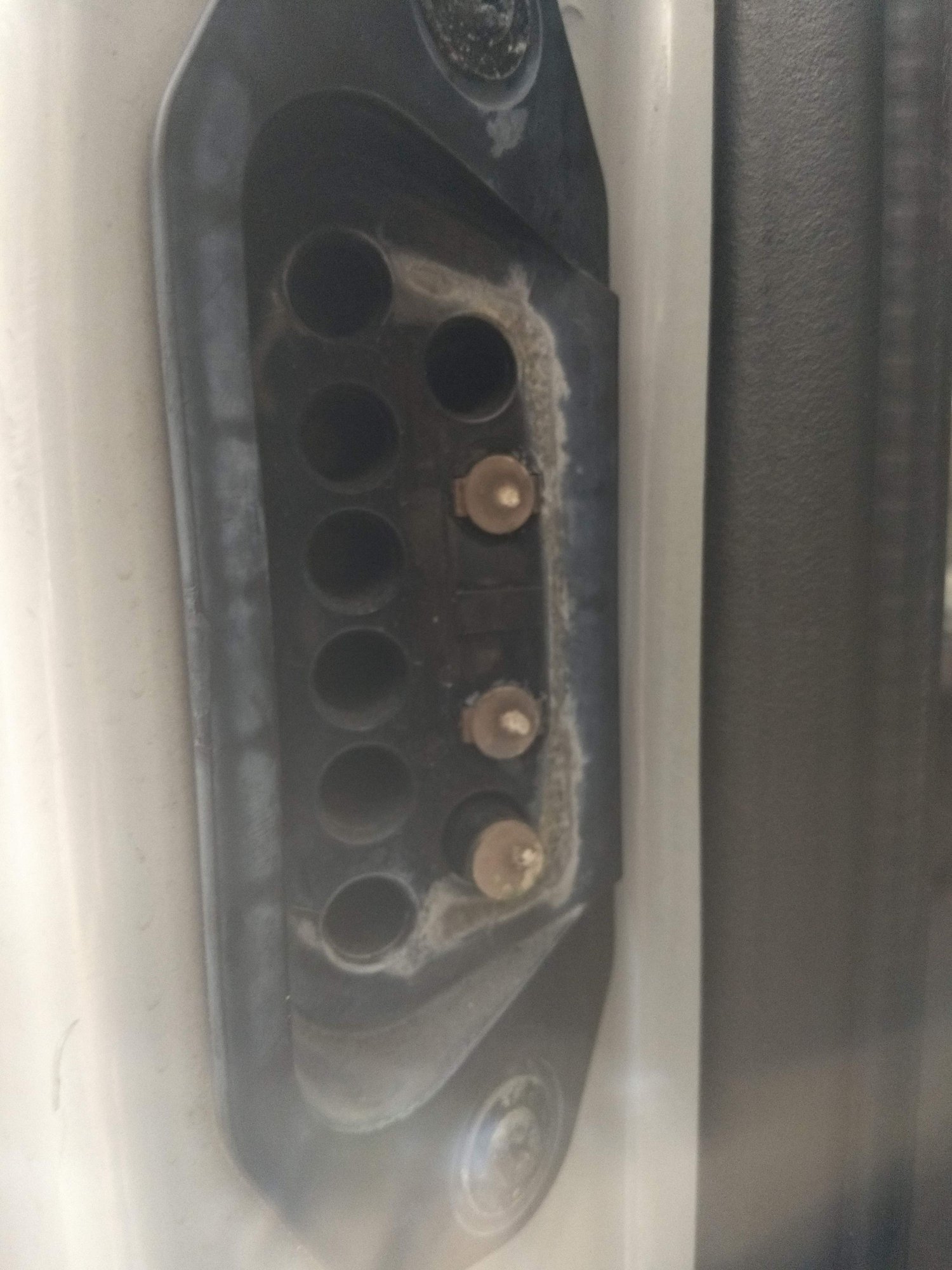

I found the solution, and it is absolutely bizarre. As it so happens, over the last two days, the passenger and driver's side sliding doors were behaving erratically when I tried to open using my key. Sometimes they would stay locked. once in a while they would open. the problem was that the insulating protection around the door closing sensor switches had come off due to age (pictrure 1), and they were getting stuck between the sensor and strike plate (picture 2). Solution was to cut off the dangling insulating pieces with scissors (see pictures below). Now I have to find a new insulating rubber boot (left and right side).
insulating rubber boot around door sensors had dried up and is torn, as you can see.
when door closes, the sensors touch these three metal plates, closing the circuit. the torn rubber boot came between the sensors and these plates
so solution was to cut off the torn rubber boot segment, but now I have to find new boots.
