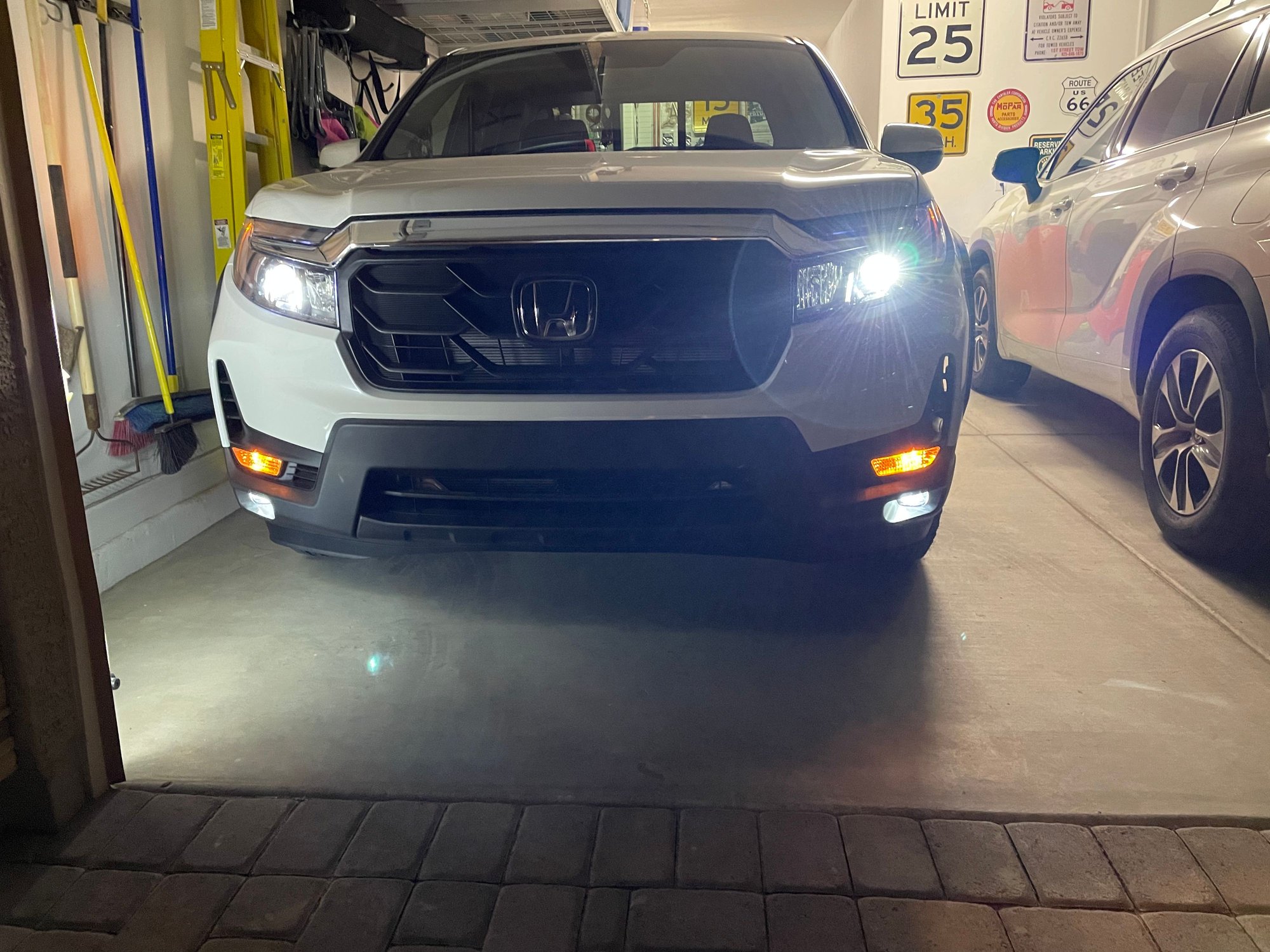

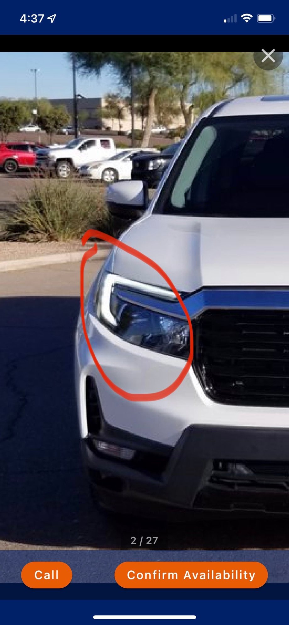

On the RTL-E it comes standard with the LED DRL above the headlights(looks like an eye brow shape). On the RTL the DRL is on the high beam light. Can I get mine wired to have the LED DRL operational and not the “yellow” high beam light?

So the E model are LED but the base model is halogen?
The DRL on the 08 CRV (others also) applies lower wattage to the high beam filament, thus giving a 'yellow' glow.
I converted the lights to CANbus compatible Auxito 9003/H4 LED (not requiring a plug and play Decoder) adding resistance to the circuit, telling the computer
there are no bulb burned out (the LED use less power).The white DRL light is a huge upgrade in appearance.
