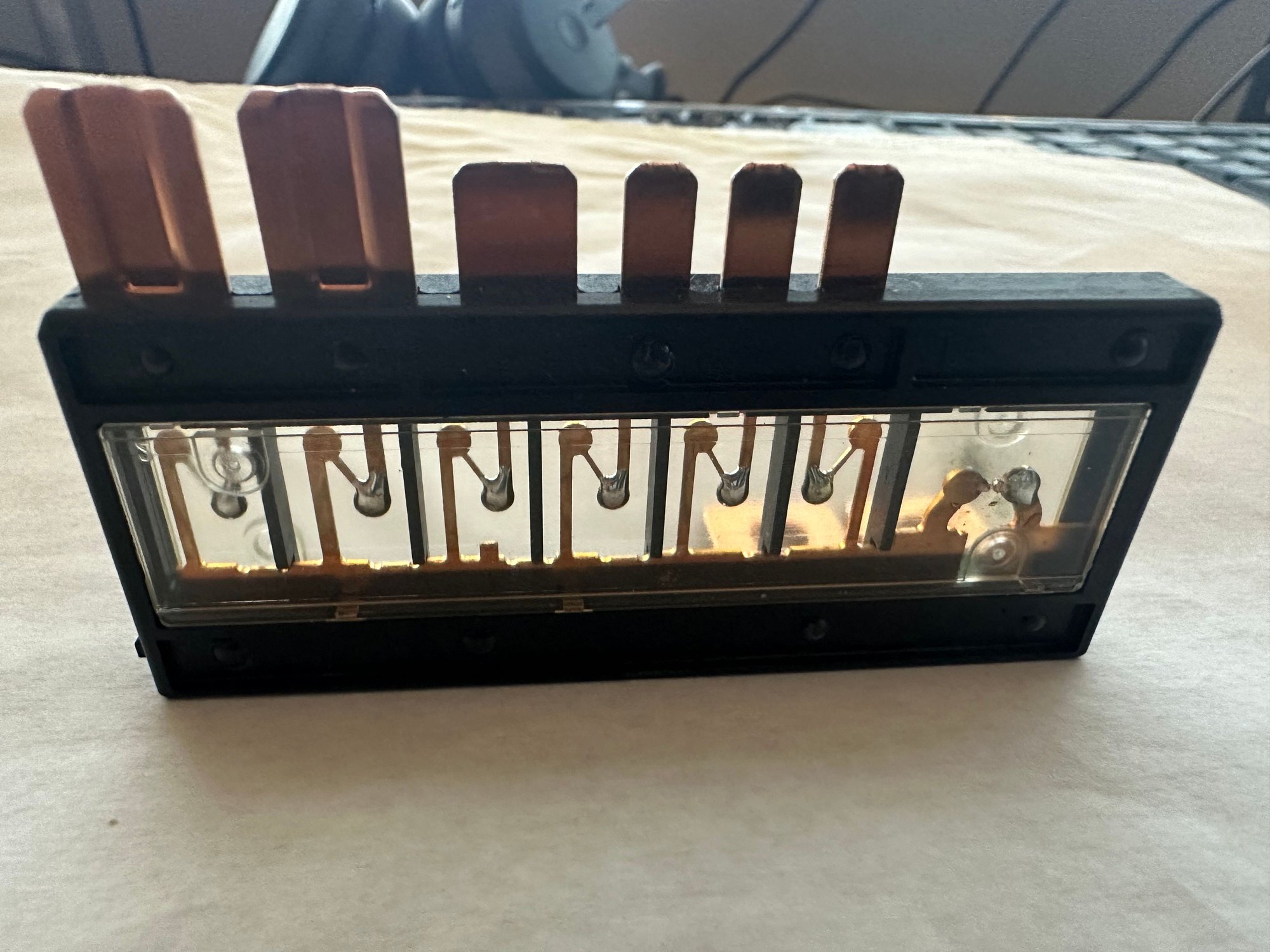

I tested the battery and it has 12 volts and I tested the fuse box and it has power but there is no power in the cabin and a white light flashes around the starter button when pressed. Other than that there is no indication the car has power. I’m stumped.

It turned out to be the fuse in the picture below. I replaced it and everything is now back to normal.
