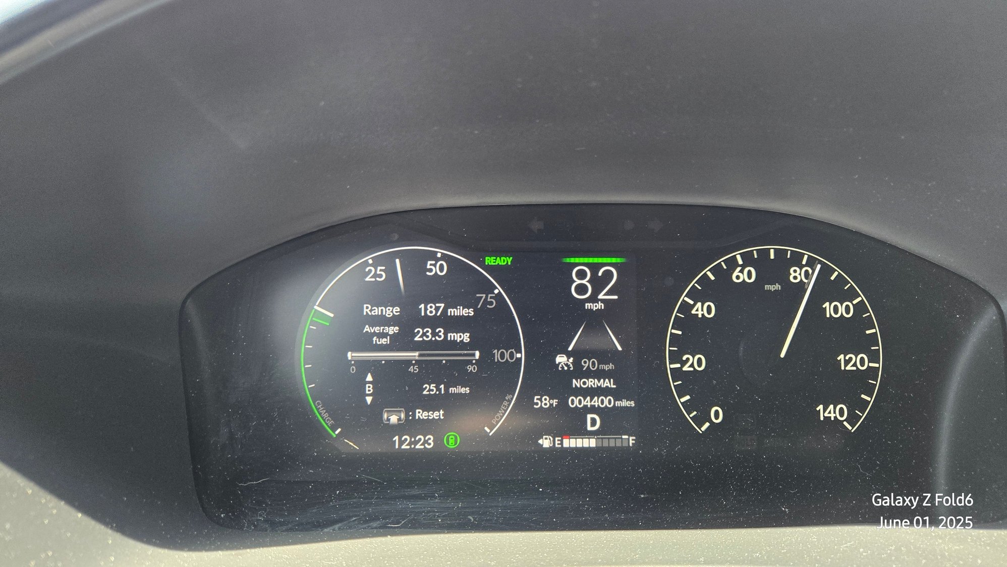

We bought a 2025 hybrid. We just past 4000miles and noticed on our last trip when I back off the throttle the power % stays at 50 for about 5 sec. Or I will be barely tapping the throttle at 10% but it would indicate 60% power and would hang there. I am getting 18mpg due to that. It only does this over 60mph.
see images notice the power % how high it is and my foot is off the throttle. All the sudden it would start working again. Also i noticed it is better if I drive in B on the shifter

we have done the exact same trip 3 time since we have bought the car. the first two trips average 34mpgs, and drive same around 80mph or 85mph . this last trip as seen i cannot get over 29mpg and when climbing hills my mpg would drop to 18mpg due to the power gauge hanging and demanding 100% when im barely stepping on the throttle. i did not think to take picture of that . these are on the way back. When i drop the speed to under 60mph there is no power hangs or demanding 100% . This morning i hooked up my Autel maxi and monitored PIDS for the APP. and, and the Power gauge matches my throttle (APP) input. so if I demand 10% throttle it goes to 10%, but it starts to hang and malfunction over 70mphs or climbing hills . when climbing hills going over Passes, i would be doing 75mph demanding 15% throttle but power gauge would go up to 90% sometimes 100% and my mpg would drop drastically. It never use to do this . Like I said we have done this trip 3 times.

go in your crv hold the APP at 10% and ull see the power gauge matches it. If you hold it 25% the gauge will match it.
this system is new to me. I'm just comparing it to our last 2 trips , and noticed the difference, especially when going uphills through passes.
I'm barely touching the APP and power gauge is spiking to 75 or 90% at times. And it hangs there when I get off the APP.
