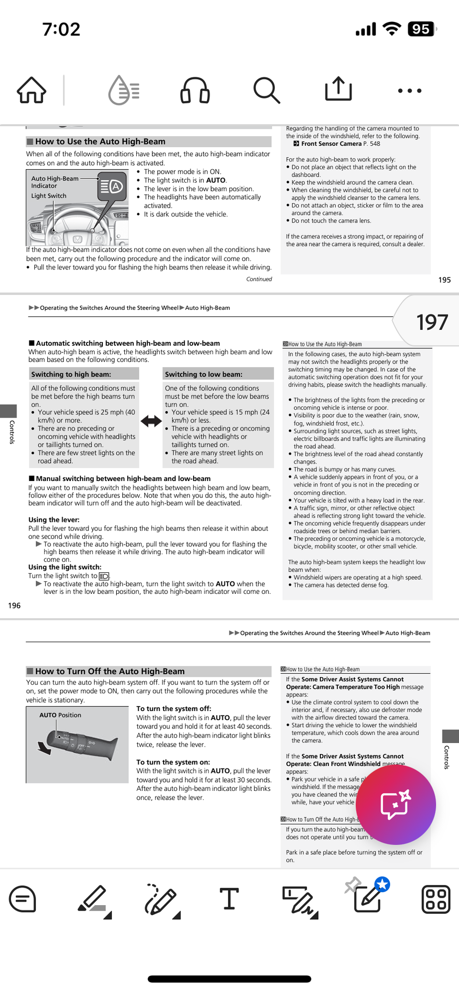

My wife and I have just purchased a 2025 CR-V ...
We are having a terrible time with the high beams activation ...
We, obviously, want them to come on automatically ...
This is not happening ... nothing is happening about 99.99% of the time at night ... Very occasionally, they will come on by themselves ...
After reading the manual and searching many websites to find the answer ... we are still out of luck ...
The last attempt included putting the CR-V in PARK ... then holding the high beams on manually for about 30 seconds ... no luck with this option ...
With today's technology ... were we have to pull over and put it in PARK to activate the high beams ?? ... Make no sense ... and it is not working anyway ...

Default OTTO is the key
The manual worked for me…
