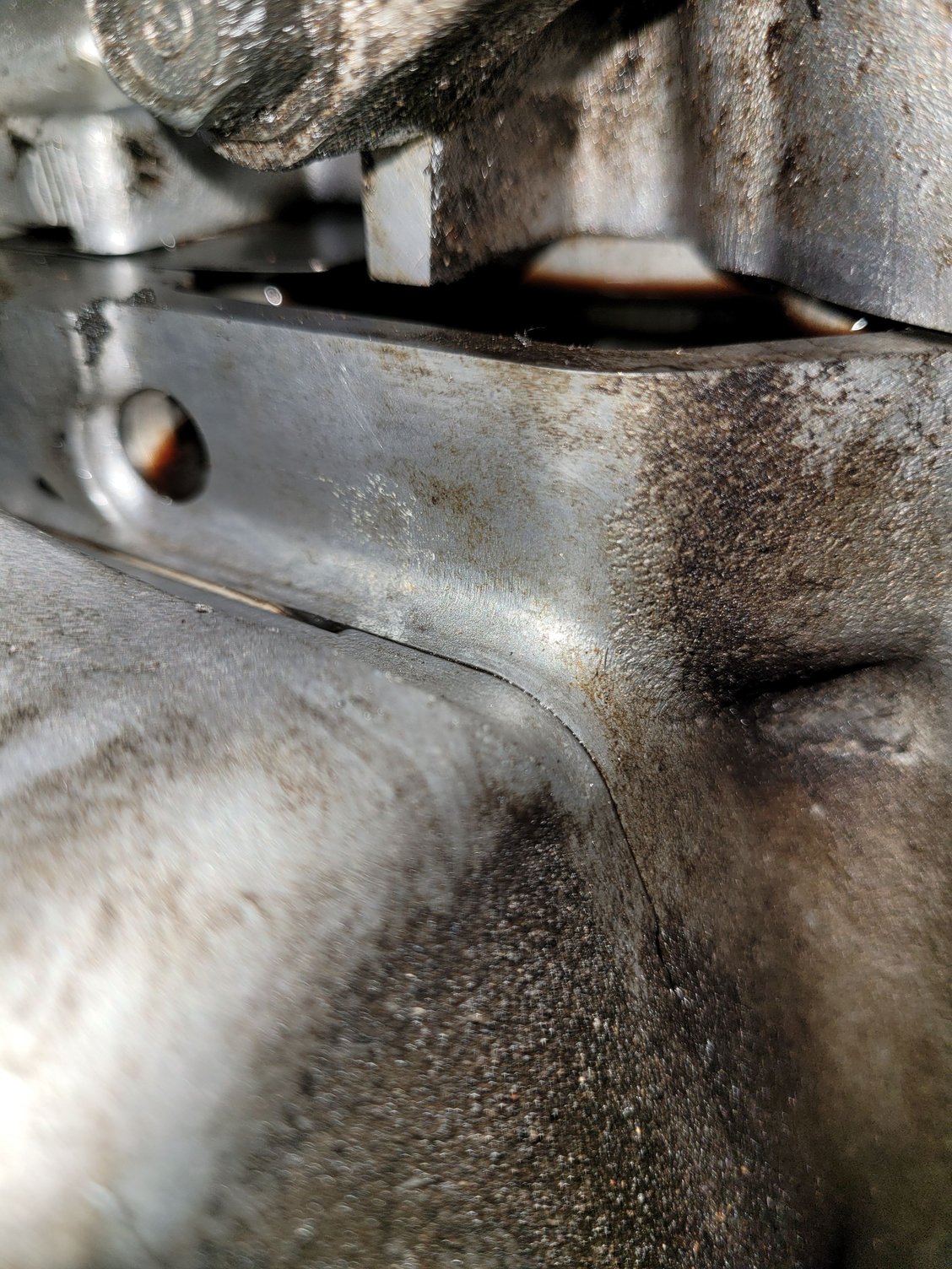

Well I am still working on this. After adding dye to the oil I discovered the actual source is in a different spot from suspected. The leak has gotten worse, creating a puddle of oil on the garage floor in less than 5 minutes of idling. Here is a pic of the general area, marked by the arrow. The oil runs to the left, runs down the engine and draining off the oil pan and into the serpentine belt which disperses it everywhere. I am asking for ideas of what might could be leaking in this area. It is not the valve cover gasket, it is lower into the engine. Appreciate the insight.

Mirror and a light to inspect the area

Intake removed, you can see where the oil has pooled. No clear idea where it leaks from. Amy ideas?
