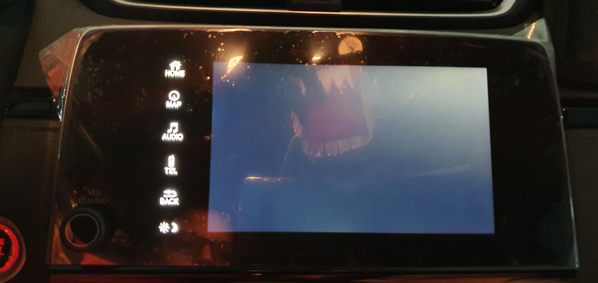

7) Thrice this week, I have noticed a flaw in the infotainment system after starting up the engine and driving. The infotainment system gets hanged up initially and displays a black screen. Even the lane watch and reverse camera image doesn't appear, in fact, nothing shows up. However, during the second instance, I found that the system started responding but was painfully slow to respond. (Attached photo 1)
Infotainment Screen Hanged
Lane Watch Camera Hanged
Audio System Fails to Load up on screen

I and many others have issue with the Screen failing and or act strange.
I had a Software Update about a month ago and it seemed to fix it.
