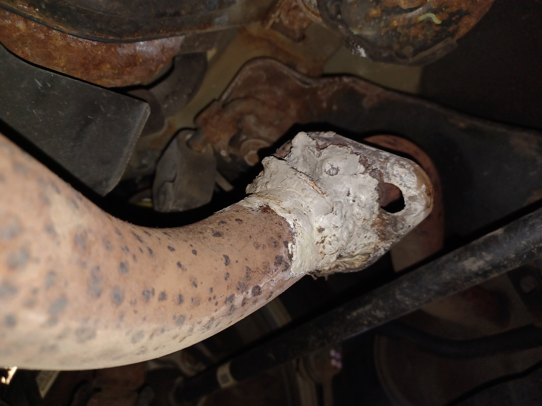

I grabbed 2 extra quarts in case it uses any. I put the car up on the lift in my shop and was greeted by this lovely attempt at an exhaust patch job, which of course was leaking like a seive.
I changed the oil and filter and added added the 4.5 quarts per the manual. All three lights went out as soon as I started it up.

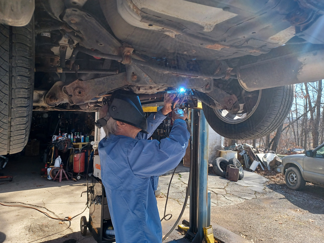

I took the car to my friend around the corner from my house who owns a muffler/ general repair shop and $50 and 45 minutes later I am back in business.
82 years young and still burning rod (or in this case wire) with the best of them.
I don't blame the guy at the car lot for this. I doubt he had the car up in a lift. The moral of this story is pay attention and save yourself $65 worth of oil and filter.
But in retrospect that shoddy attempt to patch the exhaust was better found and fixed there than it breaking in half and buggering up a rear half shaft or tearing something else up. I also had no idea that these cars are engineered to such a close tolerance that 12 ounces of oil could cause that degree of mayhem.
