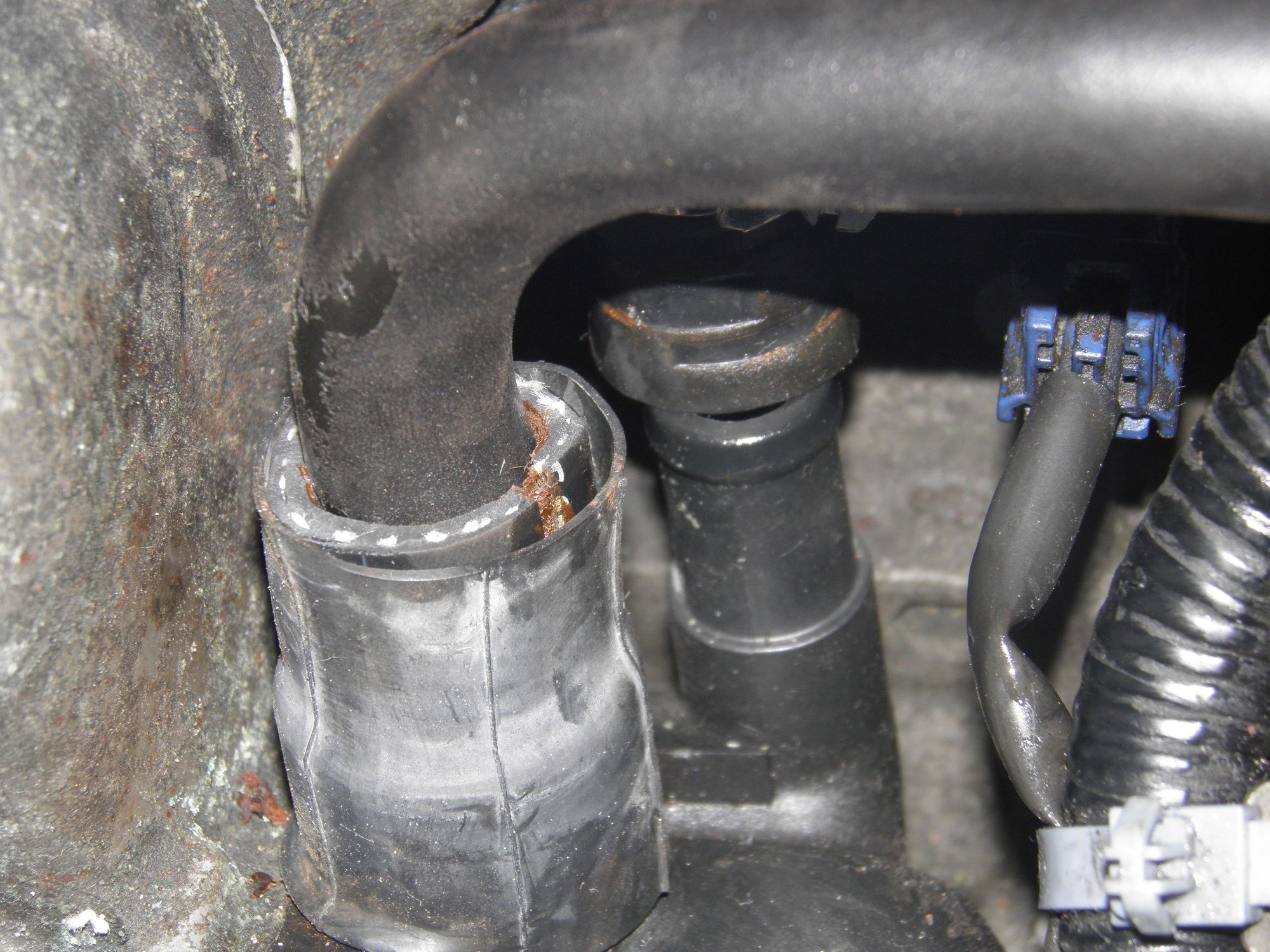

The heater pipe is replaced.
I also added a rubber sleeve so any elements would not collect on top of Thermostat Housing heater outlet and let the heater pipe rust.
Honda's engineers didn't realize, or didn't want to, that steel usually rusts. To compare, my other 35-year-old car has a similar heater pipe, which is MUCH thicker zinc-plated pipe and without any rust.
Below are the pictures of old part and other related pictures.

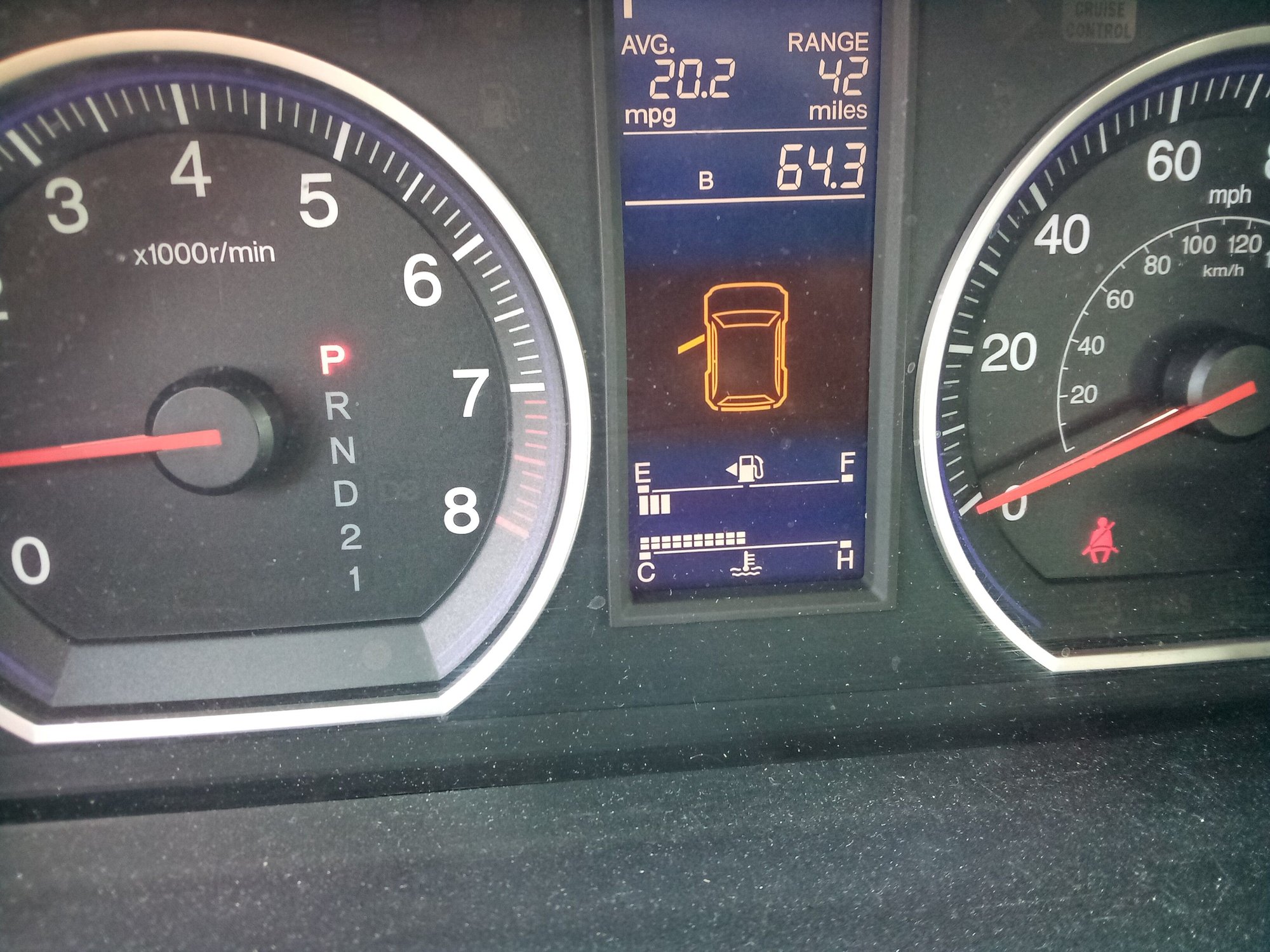

Temperature gauge was 2/3 when I noticed this leak (the pic below shows only 1/2:
To lessen any future corrosion, I panted a new heater pipe with rubber paint:
Added rubber sleeve:
Note:
all rusty hose clamps were replaced with S/S ones.
All is done, car behaves normally, temp gauge stays just over 1/3.
