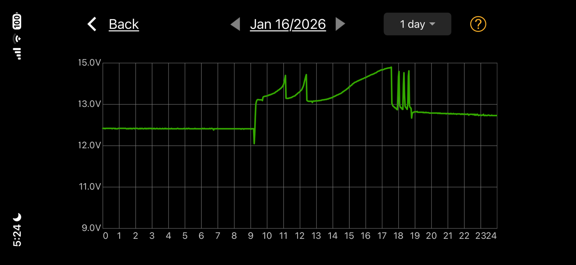

The 12V battery will only last about 3 weeks before it discharges to 50%. That is the point where you begin to damage the battery and reduce capacity over time.
So to prevent that, I have a tender hard wired so it is plug n play. However, because of the parasitic draw being greater than 50ma, the tender goes into a death cycle. (Noco Genius 1)
You can see it here beginning at about 17:30 until I turned it off at about 18:45.
If you remove(disconnect both cables) that will not happen. What will happen is you will lose your settings. The systems will reset when the power is restored AND after a short drive with some exceptions.
I avoid that by putting the tender on a mechanical timer set for two hour/day on time. That removes AC power outages from the game.
