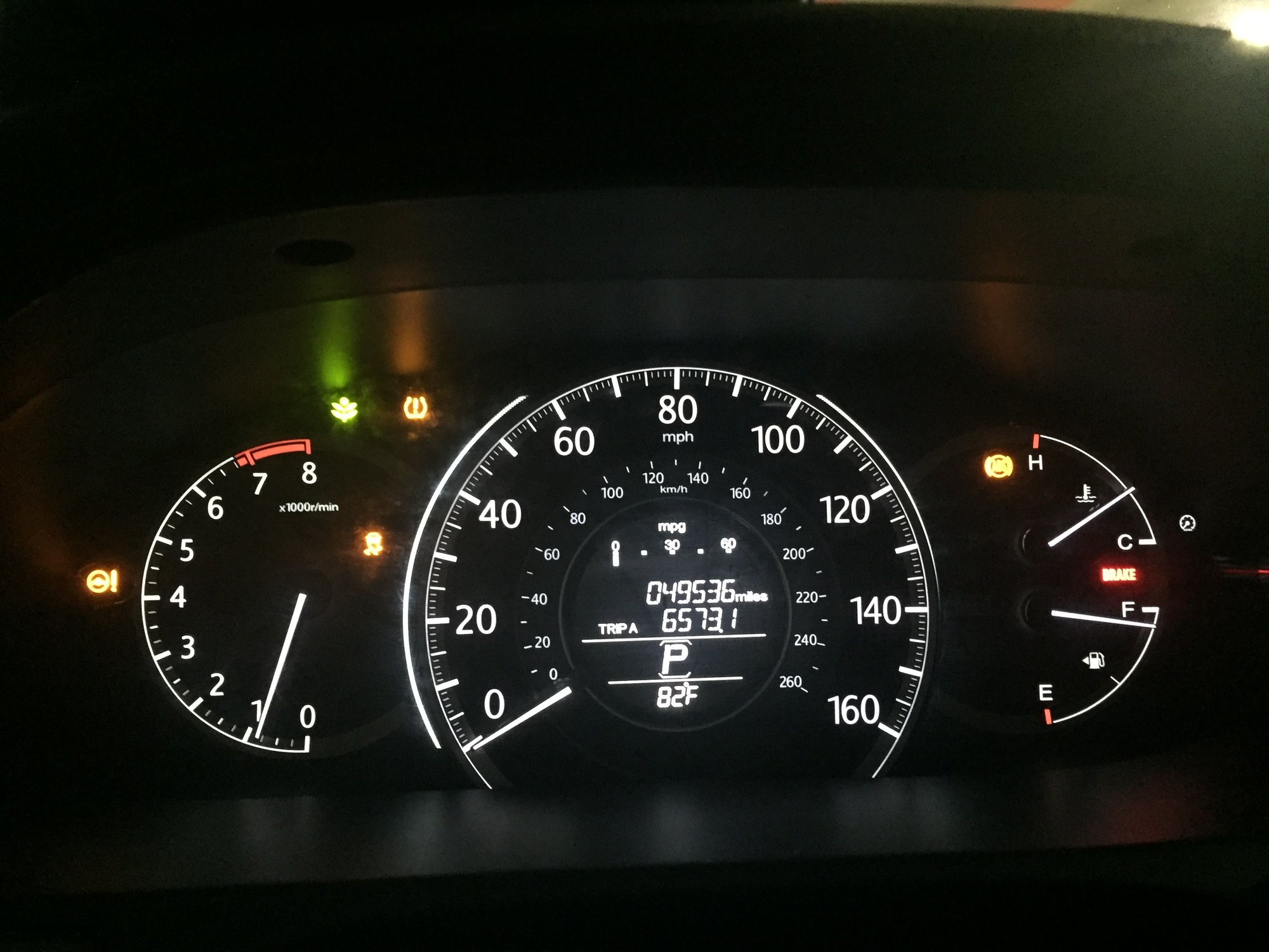

this had happened twice to me, suddenly I cant start my car, i hear clicking noise all light start to flicker in the dash board.

welcome to the forum. have you checked to see if your battery terminals are clean and secure. Are all the terminals on the alternator secure. Ground wires clean and secure.
Old Jan 12, 2016 | 05:27 PM
That's what it sounds like to me too,battery cables.

Check your alternator and battery.
