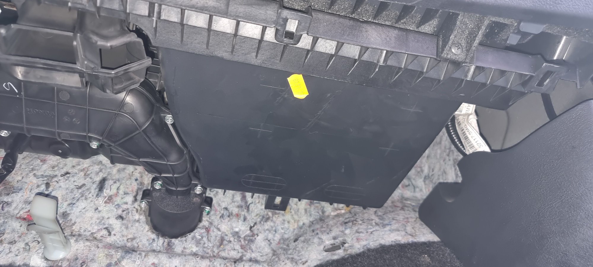

Well, that was my point. The motor is not there. When I remove the cover, what I see is just the bottom of the glowboxcompartment. The blowermotor is not located under there. I`ll take photo and try to post it here.

Here is a photo of where all info I get says the blower motor is located.
As we can see, blowermotor is not here, so where is it?

Take the cover panel off.

The panel is off. What you see here is the bottom of glovecompartment, or what you call it, you know the little storageroom to put things.
Old Mar 10, 2024 | 09:36 AM
The panel is not the bottom of the glove box. The glove box drops down and out. The blower motor must be behind the panel or what you call the bottom of the glove box.
Old Mar 10, 2024 | 11:59 AM
Take it apart. It's there. Go get it.

Now I found the connection to the power to the blowermotor, its located at the left side under the right side fottwell towards the center of the dashboard. A bit moore work to replace it then!
Now I have to start removing airvents. Not quite sure if I should bother thou, and just live with the noisy motor!
