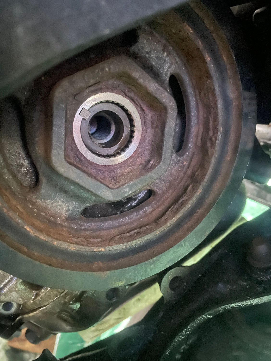

Hey man I can’t seem to get my crank pulley all the way flush with my crank shaft does the bolt tighten it flush ? I can’t remember if it was flush when I pulled it off this is what is looks like now

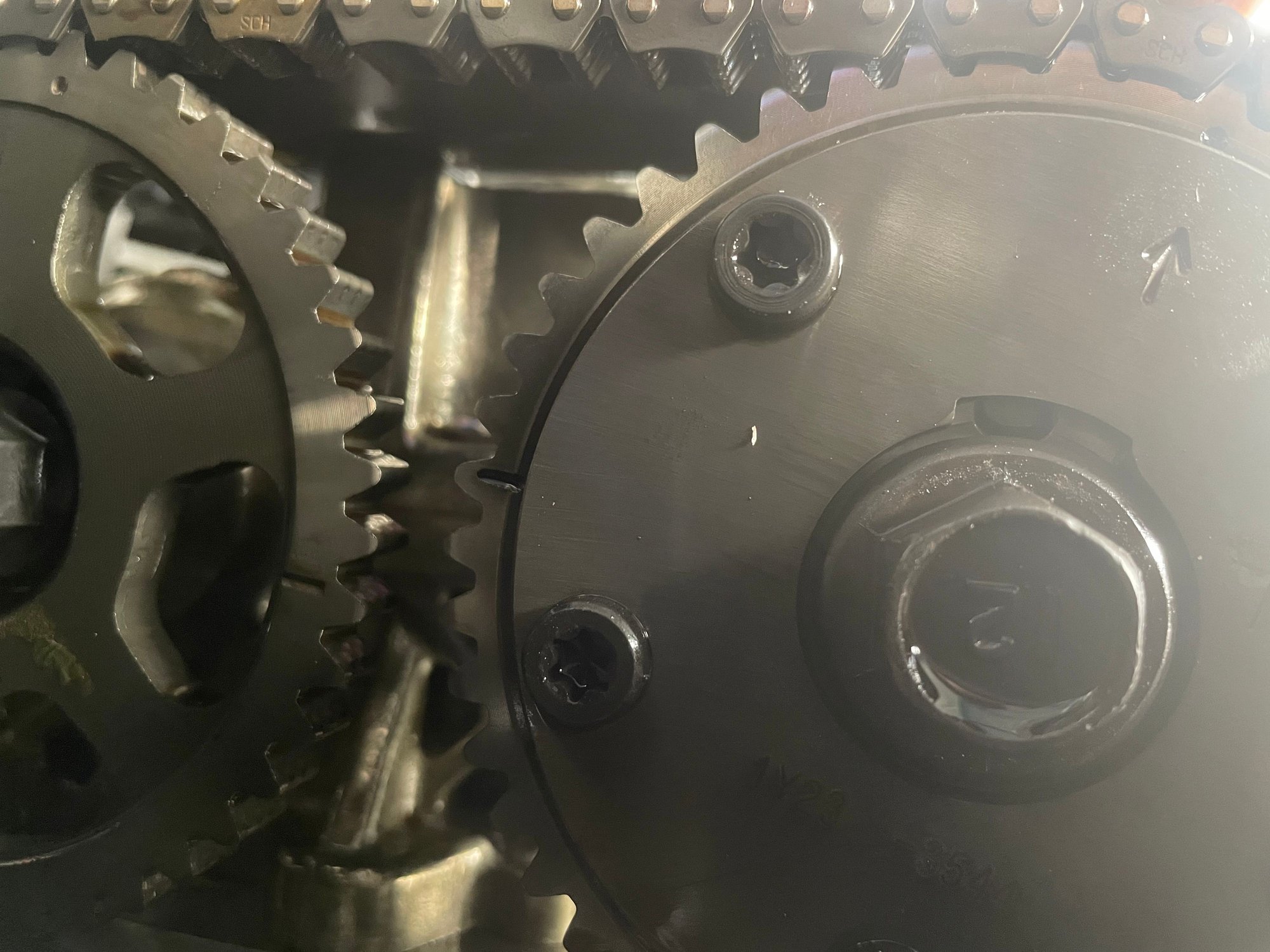

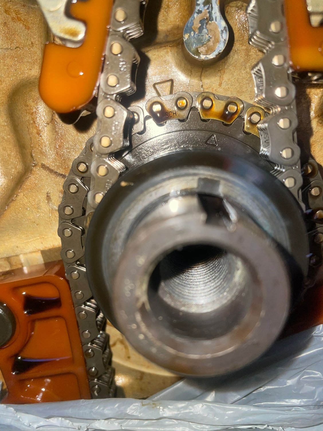

so I was able to break my vtc actuator bolt loose but I think in the process it jumped timing which is no big deal but not when I go to rotate engine back to tdc I can feel binding so I don’t want to force anything also I think the actuator may have unlocked it self when the bolt came loose now I’m wondering what the best way to get this back in time is the tensioner and chain are till attached to engine I have new ones I’m going to be re installing but I need to figure out how I can get the marks back on time here’s a few pictures.. I am working on the car rn so an answer asap would be really appreciated!!

Why is the balancer look like it's cockeyed. Also, it's splined?

I ended up getting the vtc bolt off with a huge cheater pipe , and I’m pretty sure it just the angle of the photo it’s straight in there but you can still see the splines on the pulley I couldn’t push it any further I’m thinking it’s supposed to be like that right ?
Old Apr 9, 2022 | 09:00 PM
It should contact it. Splined? Is the crank splined? If so why the need for a key? Has this been thrown together with other parts?

Yes the crank pulley is splined , that crank shaft isnt tho but this is the factory pulley on the car I couldn’t push the pulley in any further than that I’ve tried but I think it bottoms out on that metal washer behind the timing cover, maybe the bolt presses it on the rest of the way ? Although when I took it off the pulley slid straight off
