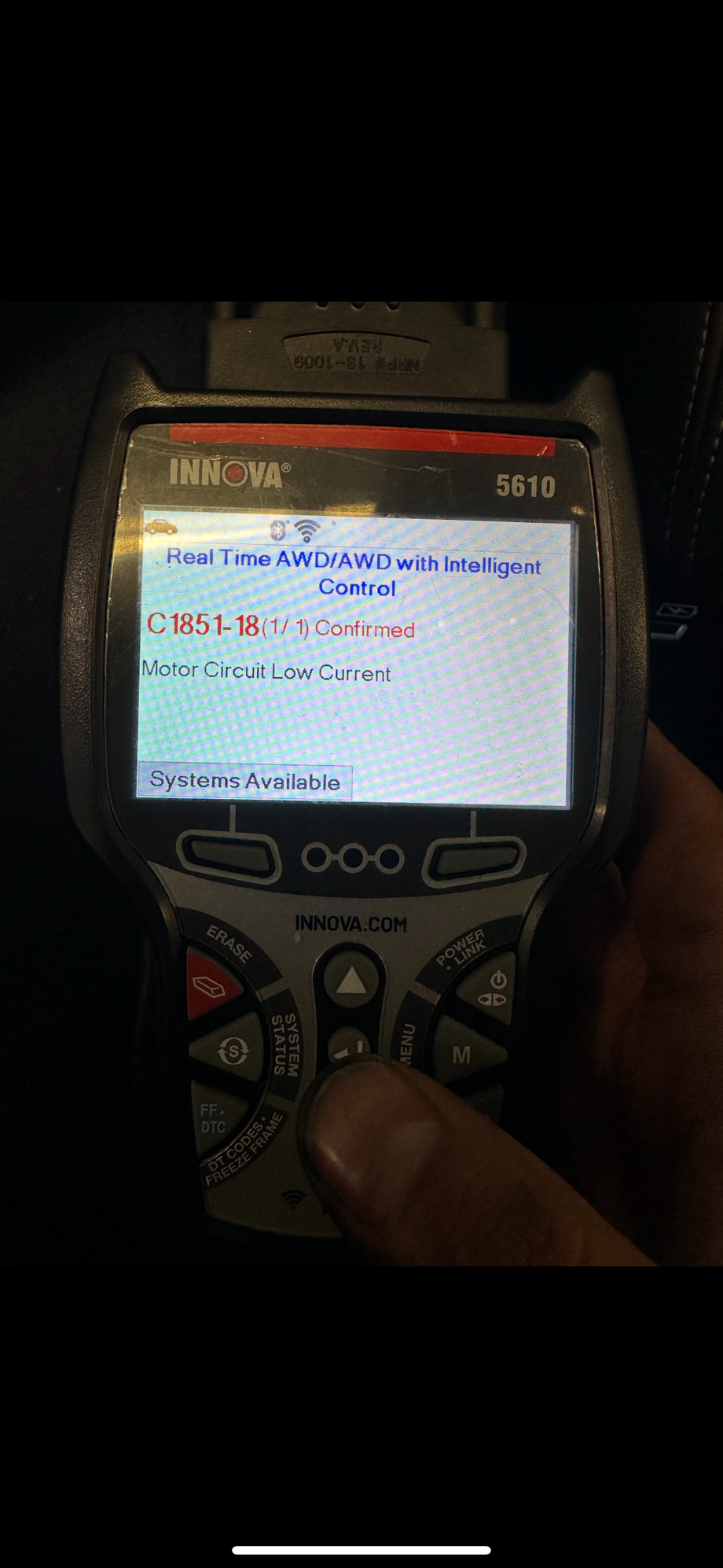

Hello, trying to diagnose the All wheel drive issue on my 2023 Honda HRV, rear diff pump is replaced, awd module replaced but still getting the error for rear diff pump motor current is low,C1851-18 1) Confirmed
Motor Circuit Low Current
after replacing the pump the issue didn’t resolved so i took it to honda and they diagnosed and suggested to replace the AWD module which i did and still have the same issue,
i want to find out How much the current amp should be in the rear diff pump motor.
