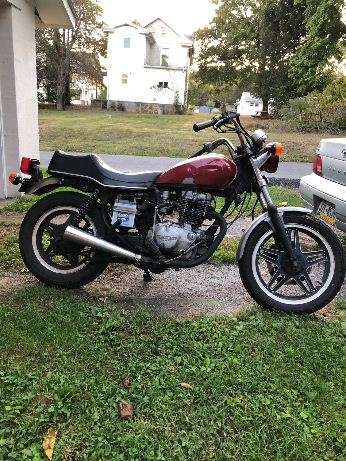

My 1979 Honda Motorcycle only starts when i ark the solenoid. Any help would be greatly appreciated!

welcome to the forum. check to see if you have power to your push button switch and if the switch is pushed to see if power continues to the solenoid, if there is power to one side of the solenoid then that may be the problem.
