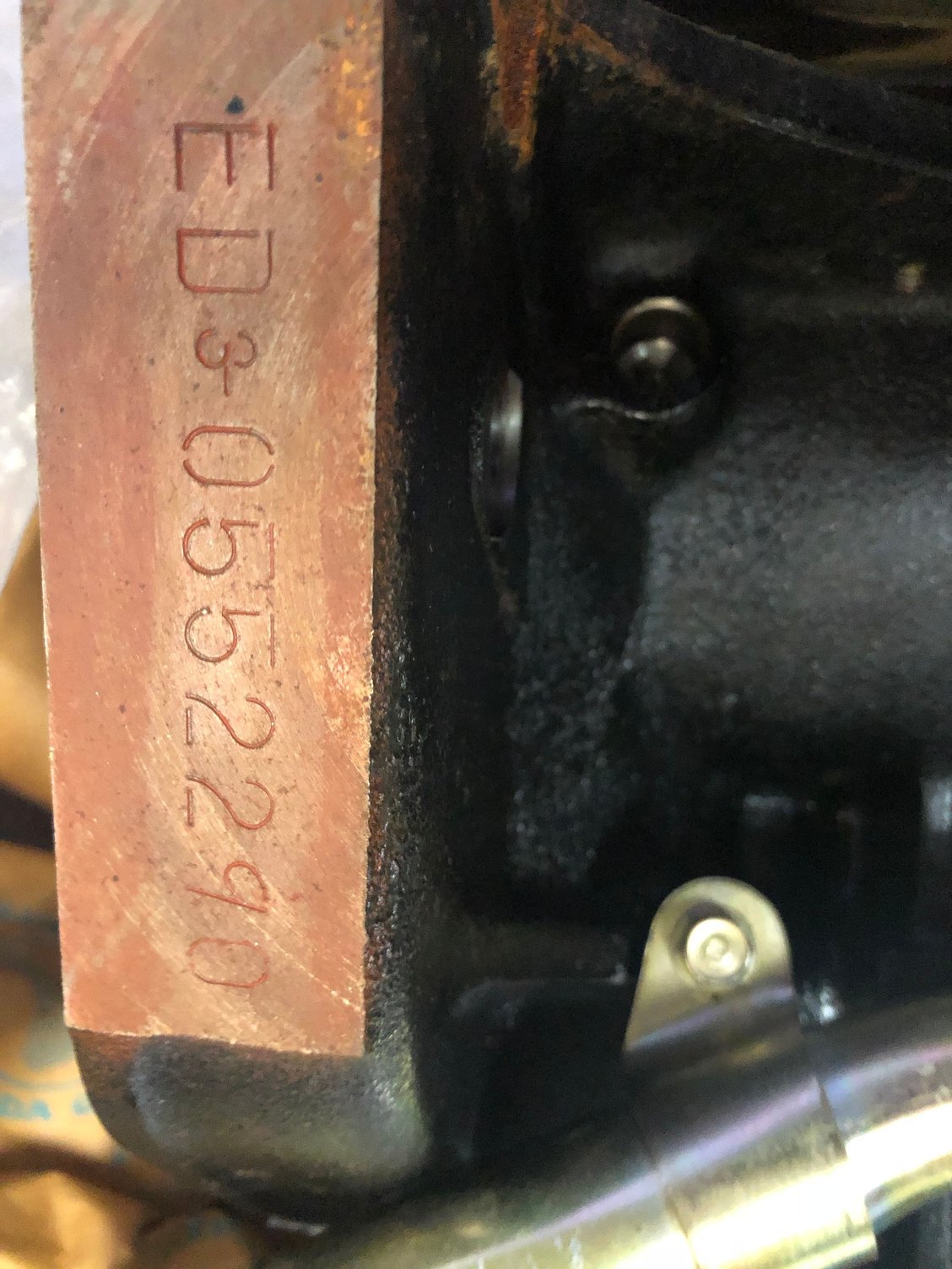

I purchased this at an estate sale and was told that it was for a 1995-1999 Civic and the numbers on the box appeared to match but the valve cover tells a different story. So I need some help to know what I've purchased Thank you BTW this is new from the factory.

welcome tothe forum. cvcc compound vortex controlled combustion model eng ed to ey for 75-79 civic and wagon. (need more info), but you can view it in wikipedia under honda cvcc engine. if you look at the side of the block, there may be a id# stamped and this may give you more info as to size of the engine.

I found the number on the side of the blocks and think I’m right about it’s meaning , please correct me if I’m wrong.I believe it is telling me that I have a ED3 block 1.5l correct? Block number

yes 75 . engine if overhauled is 1690 long block + 300 core or 2000.00 so if your engine is a new block it is worth a lot lot more.
