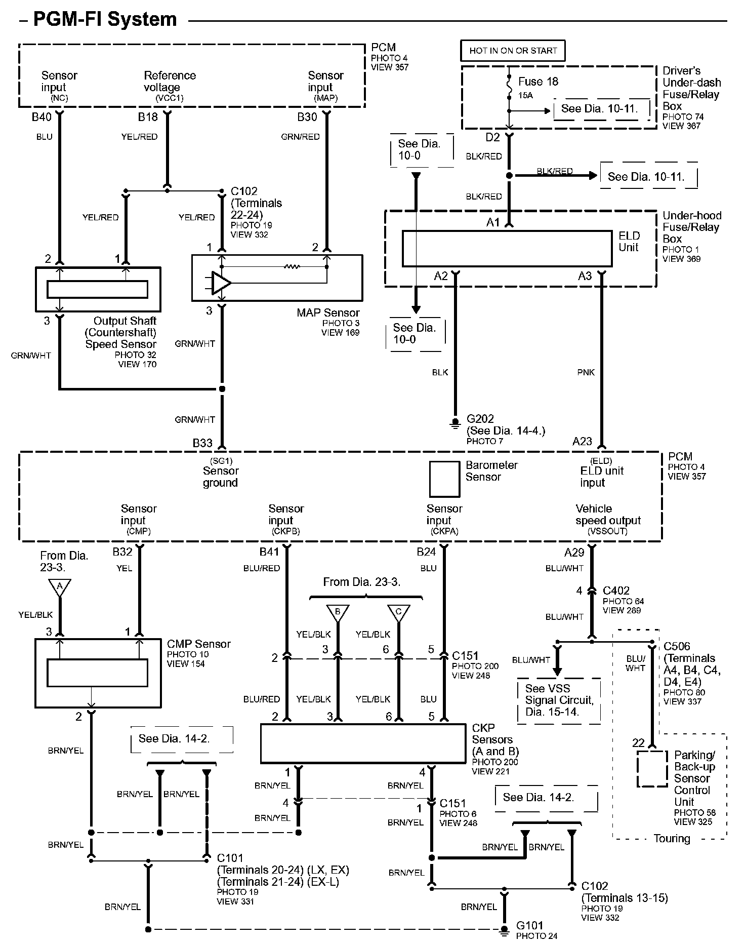

Crankshaft position sensor intermediate B circuit fault. 164,000 miles Replaced sensor 3 times ,replaced timing belt , sent ECU out to electronic shop to be tested and returned with no problems at all
guaranteed .rest DTC and after 20 minutes code again. Called Honda for pin out diagram they have none for the public.
ANY BODY have help. thank you

Default
Operation CHARM: Car repair manuals for everyone.
Home >> Honda Truck >> 2006 >> Odyssey V6-3.5L >> Repair and Diagnosis >> Powertrain Management >> Diagrams >> Electrical Diagrams >> Powertrain System Diagrams >> Diagram 23-4
Diagram 23-4
Diagram 23-4:
Next Diagram Diagram 23-5
Previous Diagram Diagram 23-3
Diagrams: Other diagrams referred to by number (See Diagram ##-#, etc.) within these diagrams can be found at Diagrams by Number. Diagrams By Number
Locations: Location photographs (references to PHOTOS) referred to within these diagrams can be found at Locations by Photo Number. Locations By Photo Number
Connector Views: Connector terminal views (references to VIEWS) referred to within these diagrams can be found at Connector Views by View Number. Connector Views By View Number
pro multis · About Operation CHARM
