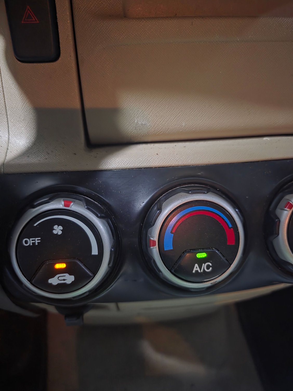

So my a/c cools and it's super cold however the fan speed seems to only have 2 speeds like HIGH and a medium high. So after a while it just gets freezing so I try to divert the air to the floor vent + upper vents and after a while my feet are freezing. I have noticed that when I go about half way between off and high the fan lowers speed just a bit. On another note I notice that when I turn the know from the off position I have to turn like 3 click before the a/c even comes on which i thought was odd. I changed the resistor as a first step and no change so just wondering if anyone has any pointers.

The temperature control don't work? Sounds like the switch is bad.
I just tested both the a/c and the heater buti took a picture of the speed control know and where it is when the blower actually turns on.

Update i went to my local LKQ You Pull it junk yard and they happen to have an exact model to my crv it was even the same color as mine. I replaced the a/c control module and now my a/c works correctly on all speeds.
