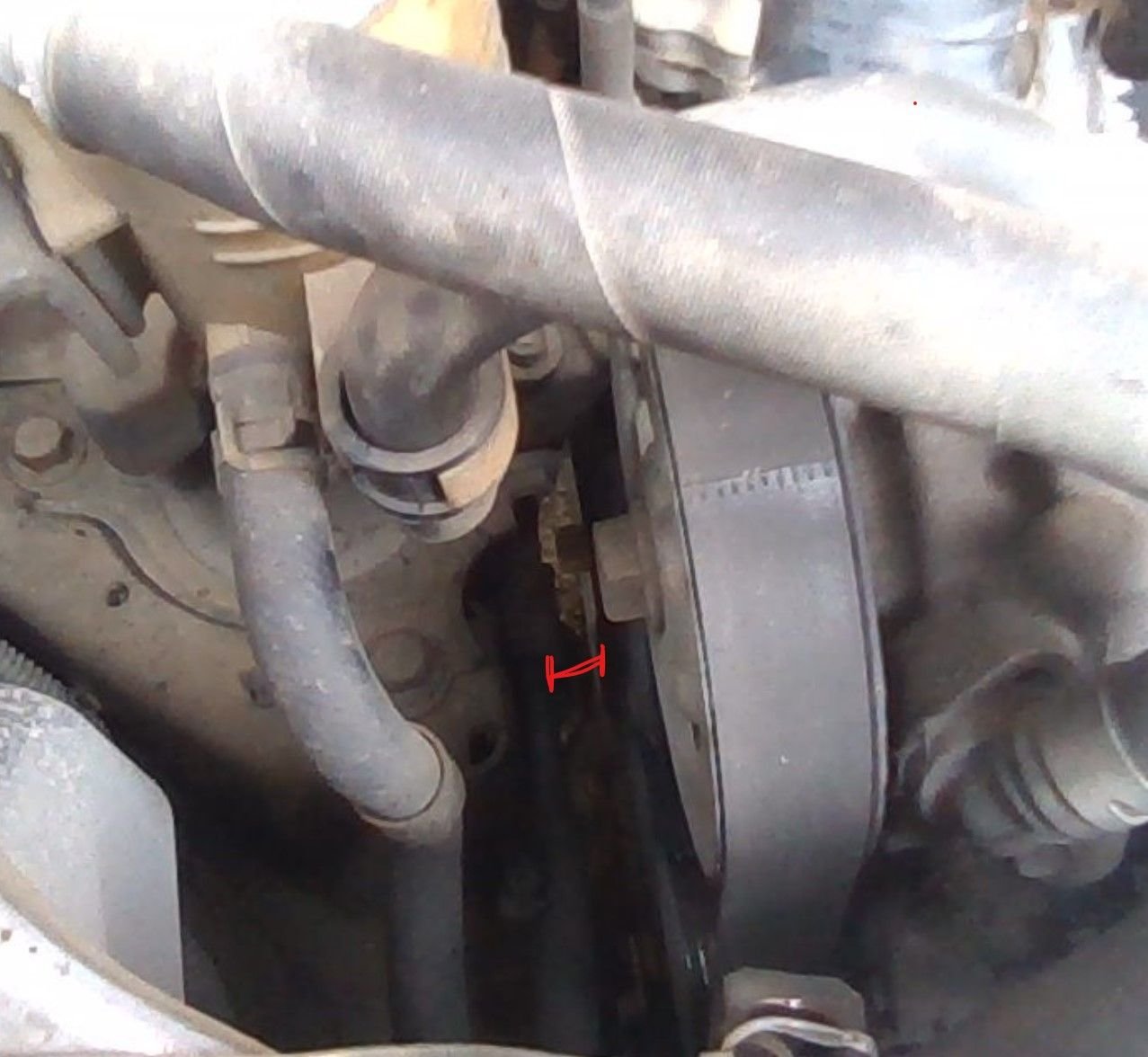

I want to clean the VTC strainer, located at the front of the engine hidden where they want it so that you have to pay honda. But now, as per usual, its just impossible, even for someone like me, swho has spent from age 12 to 35 repairing engines and gcars.. I cant get any form of sockket or anything (even oppen ender) onto the bolt on the belt tensionner puley to loosen the belt to remove the power steering pump to a gain access to the strainer cover.
How do people do this?
There is (ironicaly) a power steering pressure line routed right in front of where you need to get a wrench.
Ive watched youtube videos of ppl doingit, they just hapilly do it with a smile on their face like its nthing, but its impossible becasue the high pressure line is in the way.
There is about 15mm clearance between the pulley and the hose. see image below
So it sseems impossible to ever replace the belt unless u cut it, and then install a new one by maybe installing the tensoner in locked loose position then let it expand by releasing the main pivot bolt.
So starting from fresh from anyone whose done it?
How do i get access to the strainer.
THe belt tensonner tool that is available looks to me to stil be too long.

I have replaced my serpentine belt. The tensioner is a very strong one.
I first got the boxed end of the wrench on the bolt
Then hooked another boxed end over the open end of the first wrench
and pulled toward the front of the vehicle.
The tensioner will move.
Yes, there is not a lot of room
But, there is just enough room to do this.
I believe I removed the power steering reservoir and bracket on my 2007
Good luck and do not give up.

yeh i tried that, and rounded the bolt enough to give up and realise i need to stop.
Looks like im going to have to remove the engine mounts, and lift the engine. How stupid is that. just to clean a filter.
Old Aug 30, 2021 | 07:54 AM
Did you use a 12 point wrench or 6 point wrench?
12 point wrenches are notorious for rounding bolts.
Well, good luck.

yehh havent got access to any 6 points here. perhaps its as simlpe as that. im just getting **** weak in my 30s. its the kids I tell yah!
i now recognise that i probabyl need to remove that engine mount part anyway, so im still stuck.
