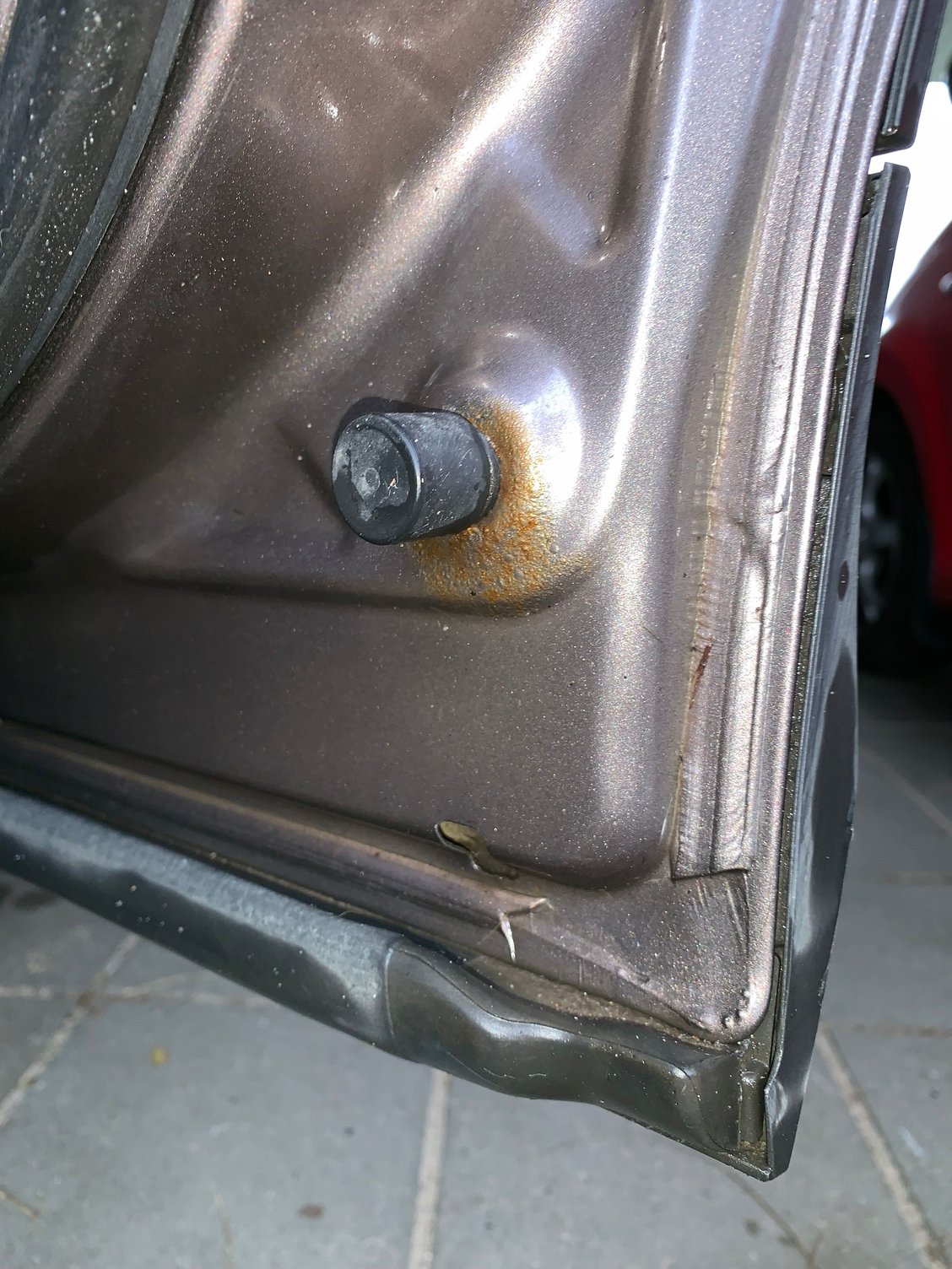

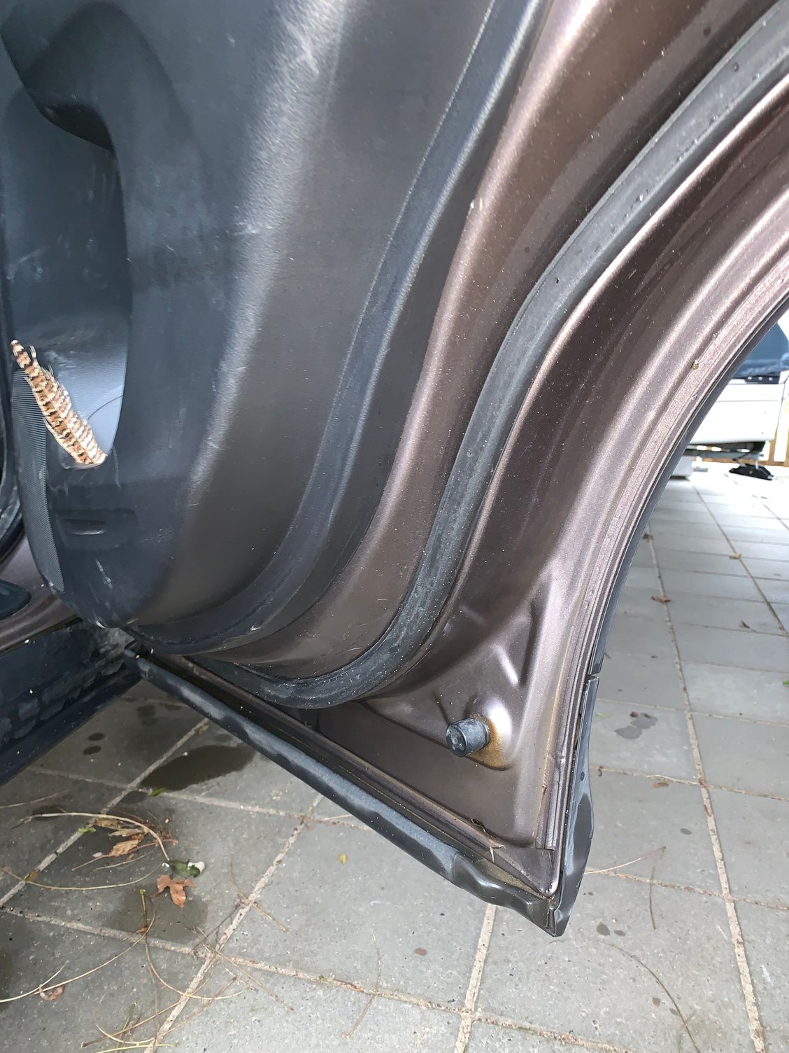

Im a very happy CR-V owner since 2014. I have done 103000 troublefree km`s and all is fine except I just found somre nasty rust in both rear doors. Anyone with similar problem? Its a 2014 1,6 diesel

welcome to the forum. I don't have a cr-v, but if you are under the 5 year warranty for Honda, rust is one of them. you might check to see if Honda will fix this. also check to see if the rear door bottom drain slots are open and clear/clean. you may want to open the door panels to see how bad the damage may be. if Honda does not warranty the rust coverage, you can sand down the rust with wire brush, and spray the rust area's with lps 3. wd-40 will wash away too quick.
