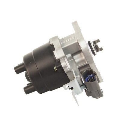

okay so I have ran into few problems changing this part out I purchased one that was suppose to be correct ill post pic but the distributor end or camshaft end is wrong it fit in there just fine but after a week it failed ive purchased three distributors that was correct number but when it came in it was wrong I was wondering if I could take that parts on the inside of old distributor and put new parts inside old one.
update ive taking everything from the ht06 and put it in mine but it still wont start just repetitive turning over before this car just started backfiring and sputtering real bad then really bad idle then nothing
this is what my old one looks like
has second ring around it
new one I keep getting sent
has no ring but same wire harness

you own all the parts you purchased, you can do what ever you need to do to get your car running. i take it you bought a rebuilt distributor from a auto parts house. there have been a few members who have ended up doing the same thing you are doing now. changing/swapping a few distributor to get the correct one to run.

was suppose to be new and didn't know if it would be a big difference I searched up and down on my old distributor and found the id its rpt h360211 but cant find it anywhere
