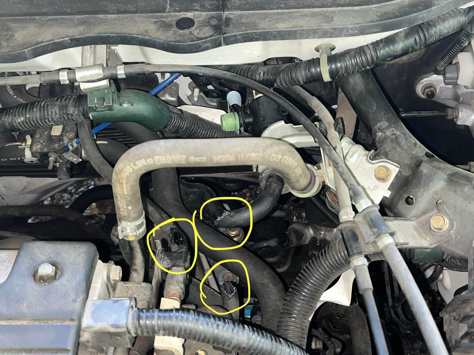

Hello friends. I know nothing about cars so small words pls. I started my car, smelled a little gas, drove 7mph over a pothole, bump, smelled A LOT of gas. Engine, oil, battery light all came on. Looked underneath my car to see if I ripped anything off on the pothole, gas is dripping from every surface. I hear a hissing noise from the top of my hood driver side. I can only assume gasoline is spraying out of one of these broken tubes.
pls help me identify what these hoses and tubes are so I can get replacements/ Google how to fix. Thank u!

Looks like someone took a knife to it. That did not happen by a pot hole. Looks like heater hoses.

I identified the smaller tube as a fuel hose and the larger tubes are a part of the evap system. Any tips or vids on how to replace these parts lmk!
