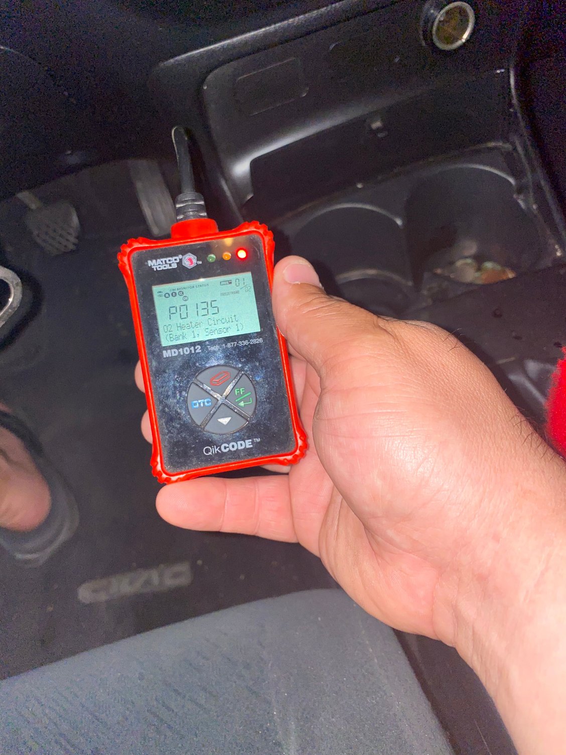

2005 civic. Starts and runs well. But once engine has been on a while and then turned off. It is hard to restart. I recently to placed to Crank sensor. Engine light is on, code says O2 sensor bank 1. I replaced the ignition relay. Just To see if that was the issue. The car sits
a lot. Used once in a while. I didn’t have this issue before the replacement of the sensor. Do you think that I just got a bad sensor?Or the o2 sensor would case this? I was thinking maybe the fuel pump since it sits for long periods. Maybe once fuel pump is hot. It stops sending fuel. It will crank just not fire up after it’s been running for a while. Anyone have this problem before? Thanks for all your help and input. Angel186

Thank you for your input. I edited my post, I changed the crank sensor. Not the cam sensor. I’m guess you are right that I have a bad sensor. I did get the part from Oriellys. I just may need to get the crank sensor from the dealer. Or find a better brand.the engine light is on at this time but the O2 code is the only thing showing at this time.

The O2 sensor code is for the heater circuit.
Either the heater is shorted or the heater is opened.
Inspect the wiring to make sure no short, fray, etc
Can also put an ohm meter on heater circuit.
Usually they are the same color.

With the engine is hot. I do not believe it is getting any spark. I checked the ignition relay and it checks out to be good. With me getting no spark, does that mean that the crank sensor is bad? When I drove it the other day I turned on the air condition and it was only giving me hot air.Does that have something to do with the O2 sensor being open as you said.?
