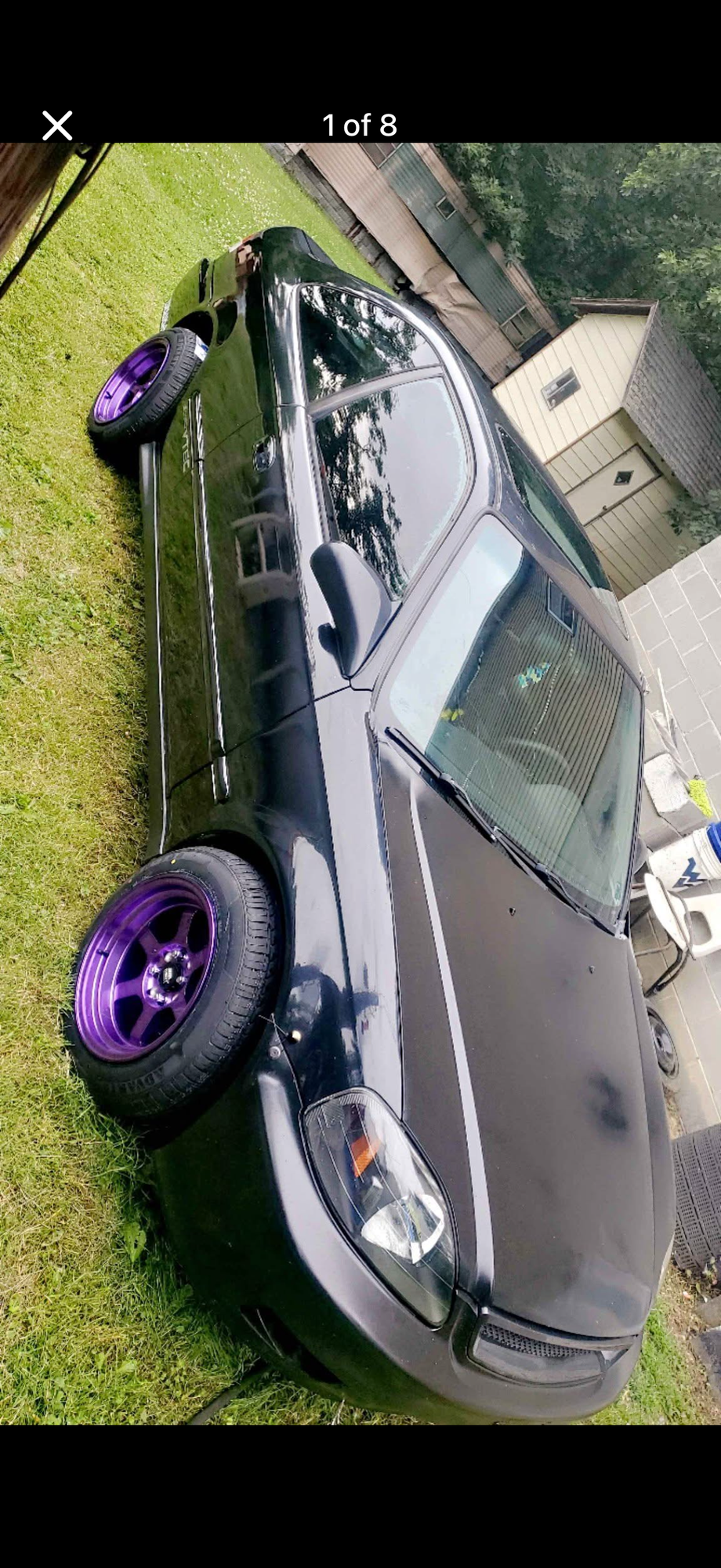

Hello, I’m new here. I recently (foolishly) purchased a 1999 Honda Civic EX coupe with a backyard engine swap. The car started out its life with a D16Y8 VTEC mated to an automatic transmission, but the guy I got it from was a gear head and upon the motor blowing up, he decided to save it rather than scrap it. Currently, it has an imported JDM D15B dual stage VTEC mounted to a 5 speed manual transmission. The car started up and ran great, I drove it an hour and a half home. However, that night I drove it to work and noticed the headlights and interior lights were pulsing brighter and darker. I went into work and came out the next morning about 15 mins before leaving to start it and warm it up. When I came back out after my shift was over, the car was off. The battery had died. I had a buddy give me a jump and went to the nearest autozone to see what I could do. Upon trying to diagnose it, I tried to pop the hood (the pull lever had broken, and the cable was cut and hanging out of the front bumper) and broke the cable off in my hand. So then I had to pull the front bumper, then unbolt the hood latch to get the hood open. The latch is currently mangled and will need replaced. I bought a new battery, since the one in it was 3 years old. I installed it and had the very helpful store team member test the alternator, which he determined that it was completely shot, and not charging the battery at all. I shut the car off, reassembled it(mind you, it’s 8 in the morning and freezing cold out), and drove it straight home. I immediately listed it back on Facebook marketplace to wash my hands of it, but I don’t know… something tells me to just try to straighten it out and keep it. There’s no rust underneath for being a West Virginia car, which is where I got it, and I’m in the Pittsburgh area and am hard pressed to find one with a body in as good of condition due to all the salt they lay down every year during winter. Anyway, here are some things I’ve determined:

Thank you for taking the time to read all of this and I eagerly await a kindly Honda guru’s input on this mess I’ve found myself in. Pictured is the car.
