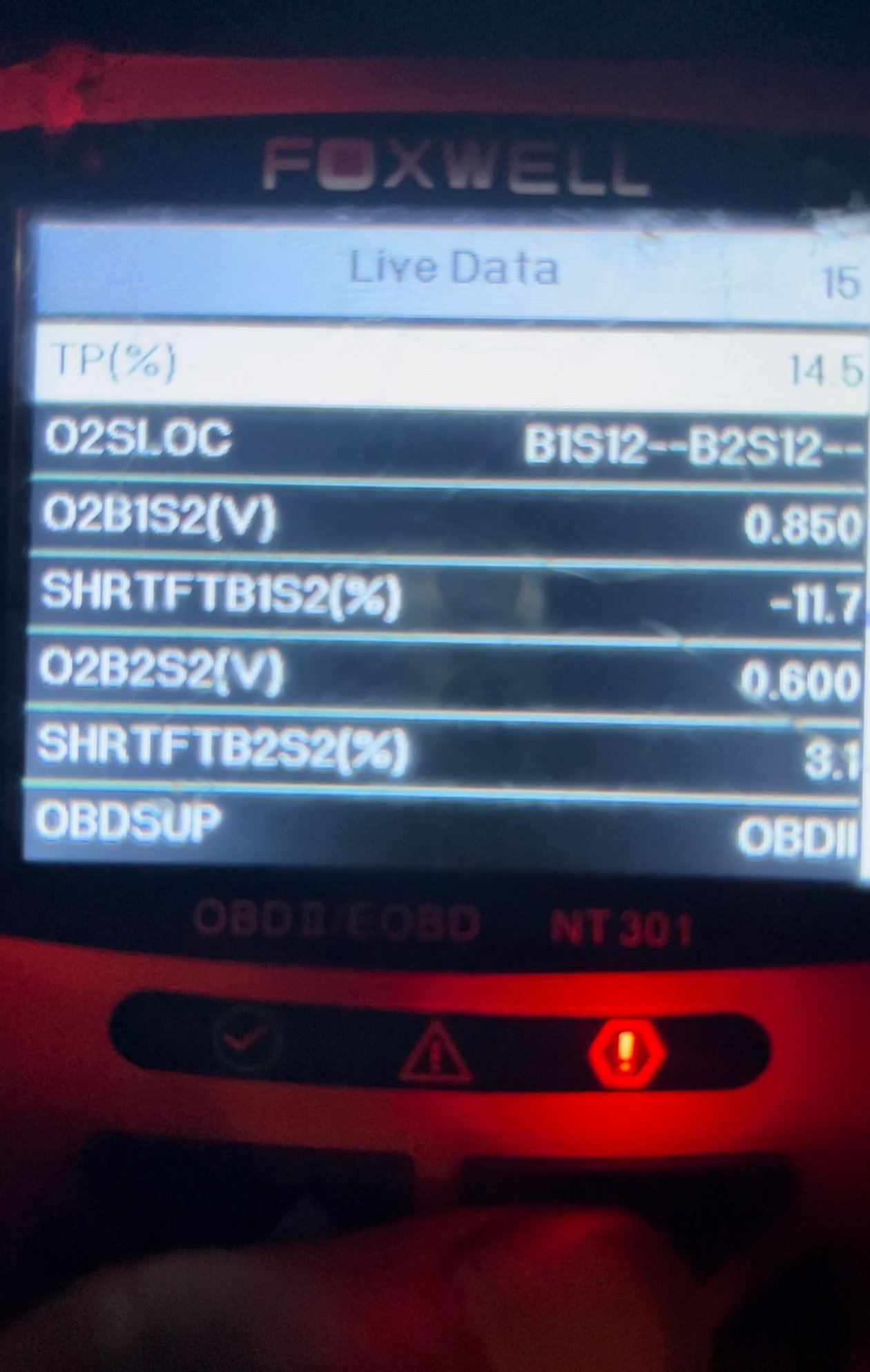

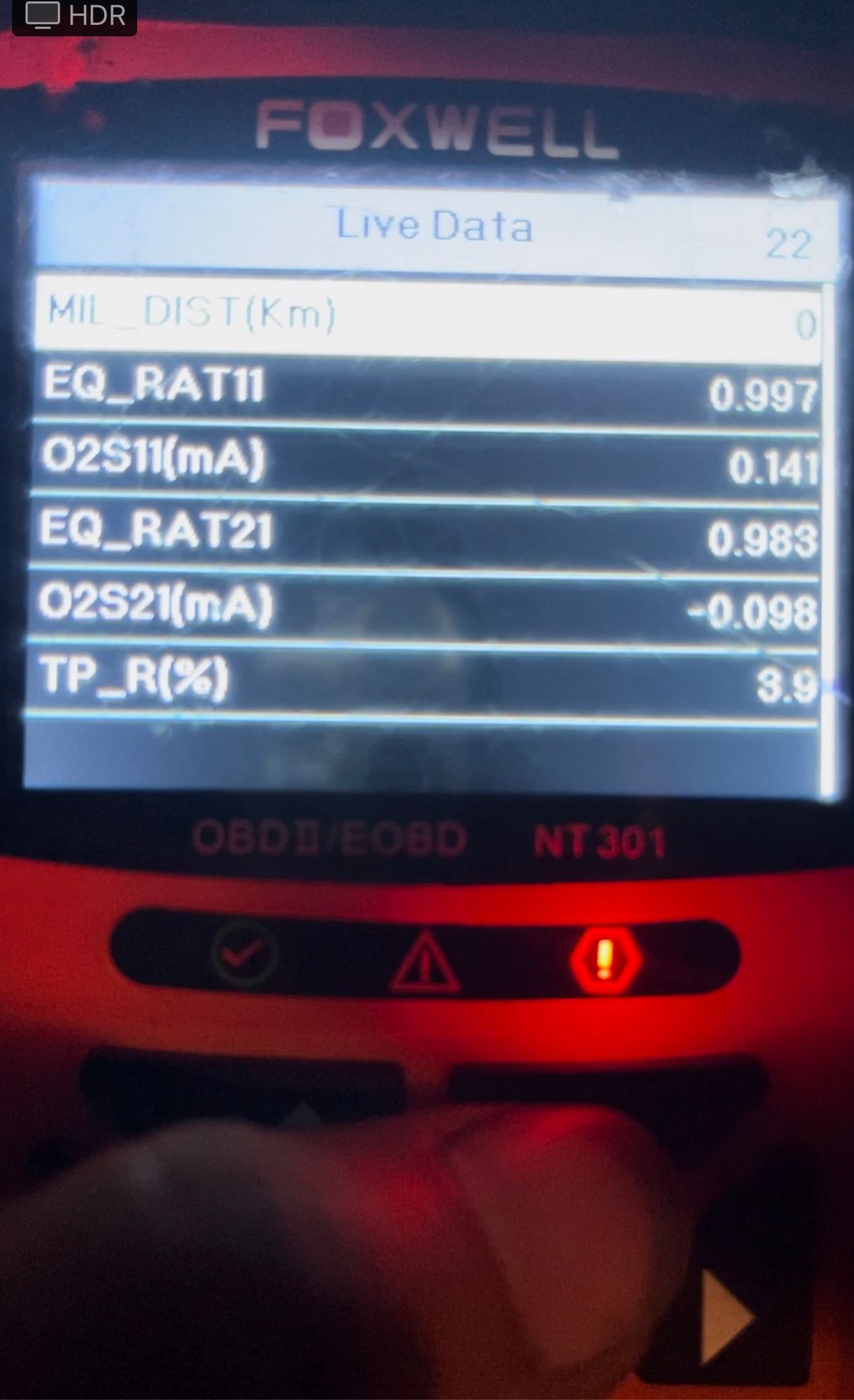

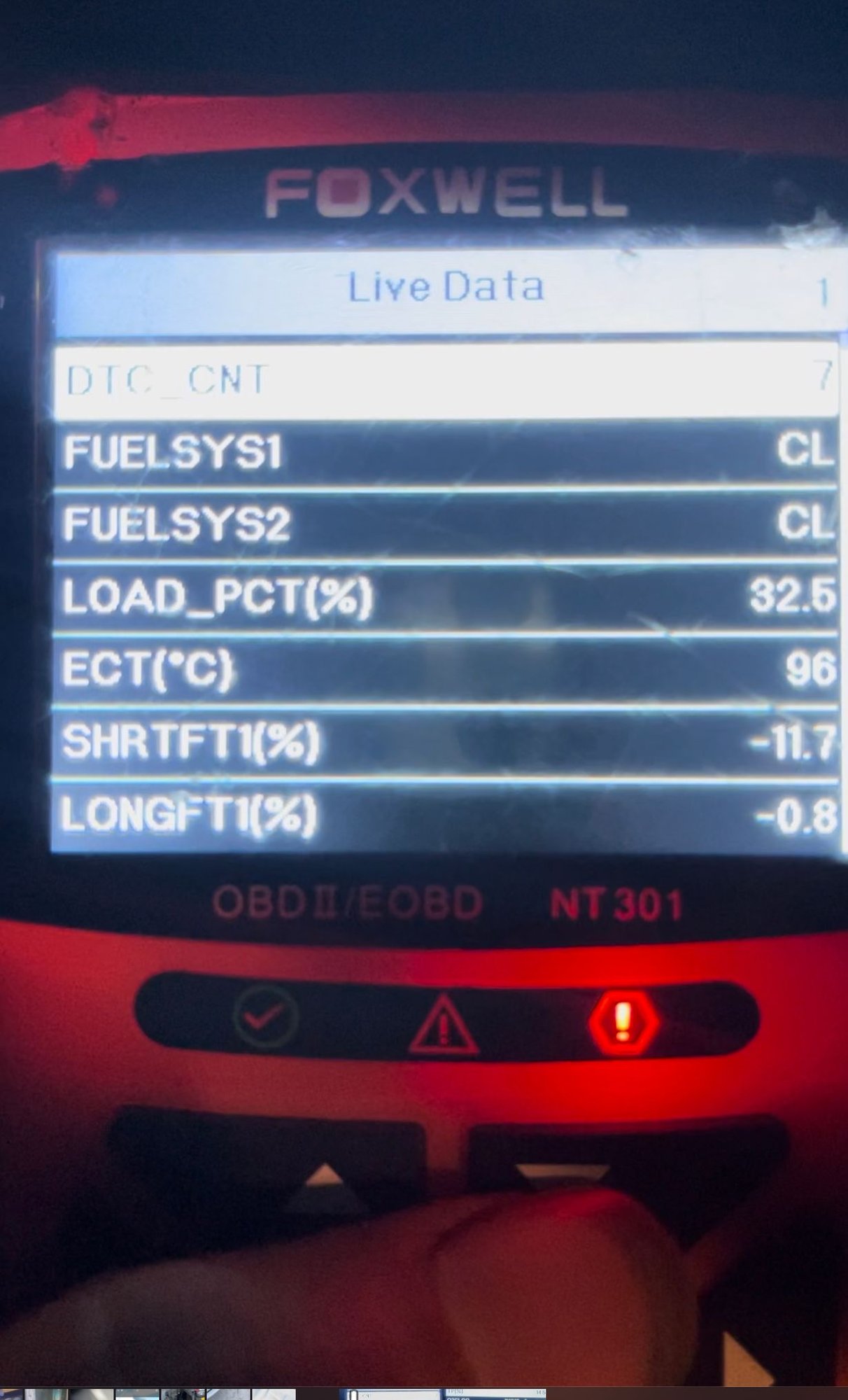

the vehicle is idling real rough with CEL flashing every now and then.
B1 short term fuel trims is anywhere from -10 to -27 at any given time. (It will go -5 to -7 at high rpm)
all other trims are within spec range
scanner is telling me 1-6 are misfiring with the random mis code. Bank 1 too rich is pending
both downstream 02 sensors are virtually stagnant and the upstream seem Ok. I changed a downstream sensor and it’s still stagnant
now, I can understand the system is perceiving a rich condition which is why it’s trimming fuel In bank 1. I can’t understand why this would be causing 1-6 to misfire, instead of just 1,3 and 6.
at first I thought vacuum leak but I figured that would affect both banks. I think I ruled out fuel delivery (maybe other then the fuel pressure regulator)
the thing throwing me is that all cylinders are missing
ill add that B2S1 is not going positive at all but it is oscillating up and down I’m the graph.
Please excuse my ignorance I’m fairly new to reading live data and I’m watching every long form video I can to try and become better at reading the data

Originally Posted by Ok_Brain
.I changed a downstream sensor and it’s still stagnant
They are not supposed to switch like the fronts.
Need to look at misfire data.
Intake gasket can do a single back or cylinder.That may be your problem.
How would that effect just one bank?
I suggest you either read some books or if you need it fixed soon take it to someone who understands automotive.
You are destroying the cat by running this thing with misfires.

UPDATE: I checked the misfiring patterns and every cylinder is misfiring almost 200 times in sequence
changed cylinder two spark plug just to test and still missing.
im wondering if the throttle position sensor is stuck a little; however no issues at all as long as you’re pressing the gas
in the scanner all fuel trims go normal and the misfires stop entirely when you give it gas
