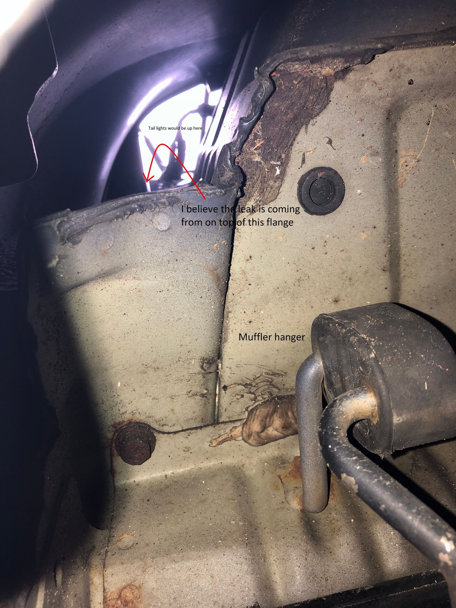

Without the video I tried to post it's probably impossible to understand what I'm talking about. I did some more work on it and I'll share it here in case someone else has a similar issue. I'm still not sure what to use to fix it and may leave it to my mechanic.
This picture is looking up from under the car near the muffler. The daylight in the picture is only because I removed the tail lights.
Old Jan 1, 2020 | 08:07 PM
Is this view from under the car, looking up?
Is that daylight?
That seems to be a pretty big hole??

Brought it to my mechanic, who's very (way too) thorough. He took off the back bumper and found that the vertical seam on the right side was leaking very badly. He resealed both sides and billed me for 7 hours labor. A 7 year old car really shouldn't have this issue. Traded it in right away.
