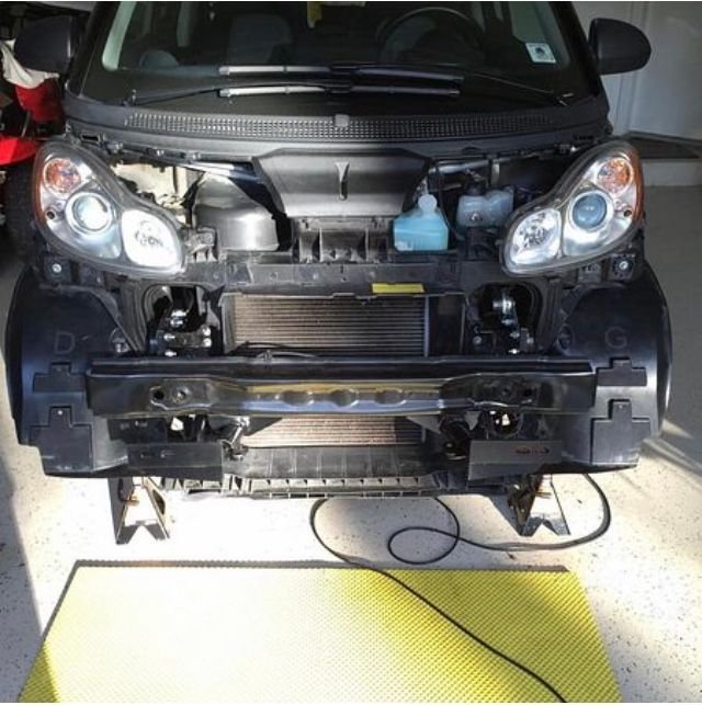

Obviously not a CR-V but this is an example of the level of disassembly you will encounter installing the hitch assembly.
