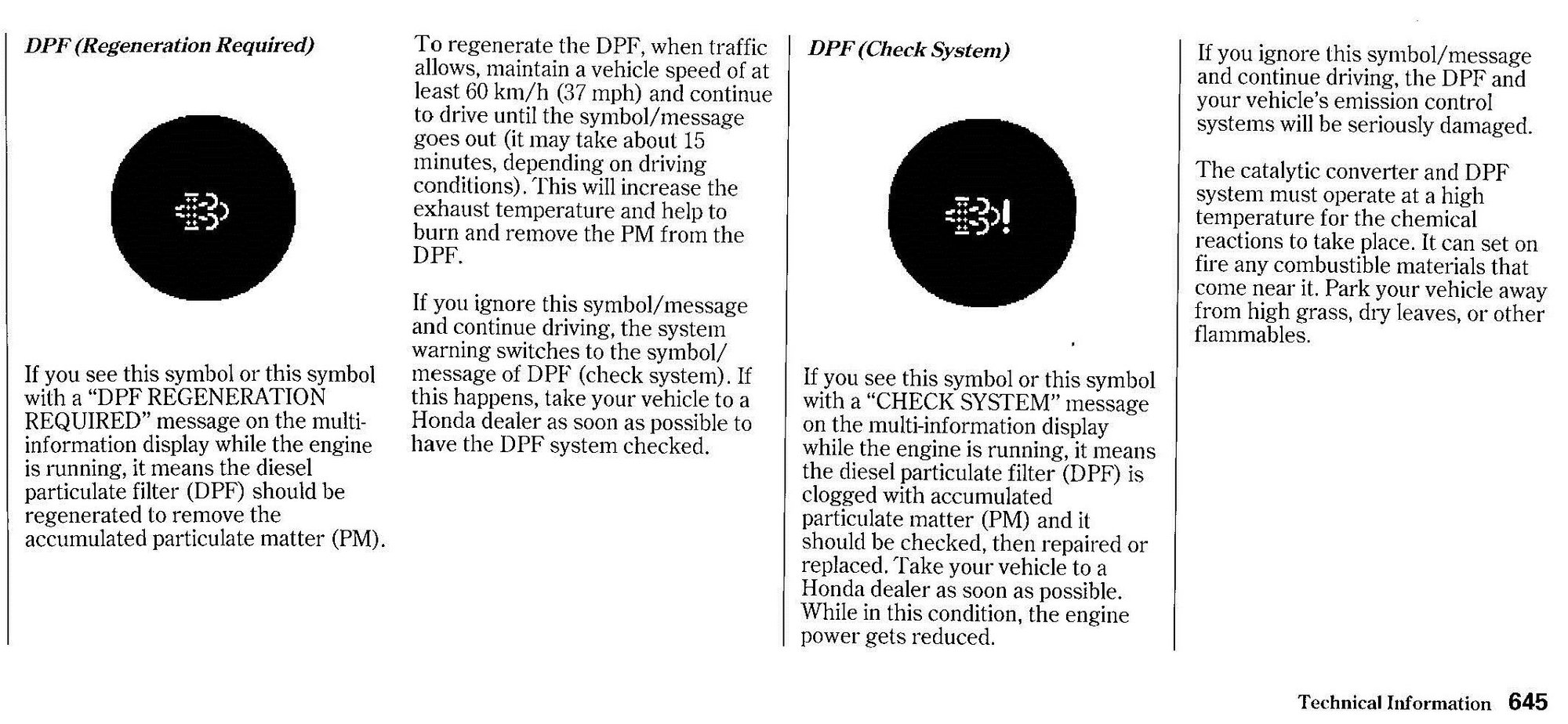

Bit lengthy for a first post but I hunted around to try and find something properly official without success so hopefully you may find it interesting or useful.Honda’s position on how the stage 1 DPF purge works on their diesel cars is officially: -

The car monitors the journey you are taking and if you have been driving for the correct amount of time at a suitable consistent speed, along with such things as temperature engine and probably outside temperature etc. Plus it thinks the DPF needs a purge. Then the indicator lights up to tell you it’s about to enter into DPF cleaning mode.
It is generally accepted that a DPF purge needs to happen in one operation so as far as I am aware you cannot do three quarters, then go out and do the last quarter at another opportunity, so in the unfortunate event that you was approaching your journeys end or some body makes you slow down and drop out of the purging process or similar, the entire process will need to be done again, however you are at least in a position where you are now aware your DPF filter needs purging. So I reckon you need as soon as possible to retrace your journey and fingers crossed your Hondas computer will try again (yes that one that thinks British summer time started at Christmas!).
I would recommend doing the second journey at a time when the motorway is quieter, I believe that motorways are generally where the car is happy to do a DPF purge as it is most likely to satisfy Hondas recommended use ie

Unfortunatley you will not be able to follow some motoring organisations advice ie the A.A. advise
https://www.theaa.com/driving-advice...culate-filters
Don’t ignore a warning light
If you get a warning light showing that the filter’s blocked, it should be possible to complete an active regeneration cycle and clear the warning light by driving for 10 minutes or so at speeds over 40mph. (Similar to my handbooks 15 minutes and 37mph)
If you ignore a DPF warning light and keep driving in a relatively slow, stop/start pattern, soot will build up in the filter until your car goes into ‘restricted performance mode’ to prevent damage.
If you let it get this bad:
  • Driving at speed alone won’t be enough.
  • You’ll have to get a dealer to do a manual or ‘forced’ filter regeneration.
  • In extreme cases they may have to replace the filter which can cost at least £1000 plus labour.
In most cases there’s only a short time between the DPF being partially blocked and it getting so blocked it needs a manual regeneration.
You cannot do this because it appears the following function:-
As been apparently removed from your car’s computer.
However I am open to hear from anyone who may have had the light come on in the way the handbook describes, and how they went on, as the main reason for posting this is because there is very little out there in the way of information. Even if we get some feedback of experiences with the light coming on we may be able get an idea of what we can do to trigger a purge without resorting to bothering the dealers.
Hopefully this at least clarifies what’s happening with your DPF light.
