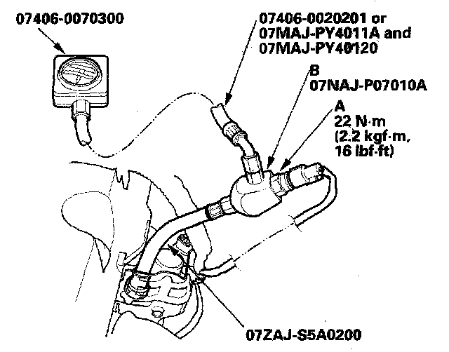

10. Remove the rocker arm oil pressure switch (VTEC oil pressure switch) (A), install the special tools as shown, then install the rocker arm oil pressure switch (VTEC oil pressure switch) (A) on the oil pressure gauge adapter (B).
NOTE: Install the switch in the reverse order of removal with a new O-ring.
11. Turn the ignition switch ON (II).
12. Do the VTEC TEST in the INSPECTION MENU with the HDS.
13. Check the oil pressure.
Does the oil pressure increase to at least 392 kPa (4.0 kgf/sq.cm, 56.9 psi)?
YES - Replace the rocker arm oil pressure switch (VTEC oil pressure switch), then go to step 21.
NO - Inspect the VTEC system. If it is OK. Replace the rocker arm oil control solenoid (VTEC solenoid valve), then go to step 19.

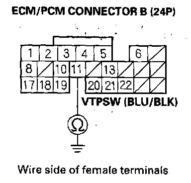

16. Disconnect ECM/PCM connector B (24P).
17. Check for continuity between ECM/PCM connector terminal B11 and body ground.
Is there continuity?
YES - Repair short in the wire between the ECM/PCM (B11) and the rocker arm oil pressure switch (VTEC oil pressure switch), then go to step 18.
NO - Go to step 25.
