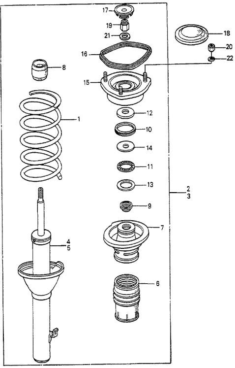

Hi all, I'm in Australia and new to the forum, which looks a great resource. My issue is that the front shocks I've bought don't come with the associated bushes and bump stops to replace the originals, which are 'buggered' as we say down under. I've searched the web and have come up blank so was wondering if anyone knew of any NOS/aftermarket suppliers, or perhaps an alternative from another maker that may fit.
Essentially, I need the stepped seal that locates the upper shock rod in the seat (part no 51724692004). It is No 9 in the below diagram. The ones that came out are completely shagged.
All advice greatly appreciated.

Hey there, unfortunately I couldn't find any anywhere, so ended up getting a mate to turn me up some on his lathe.
