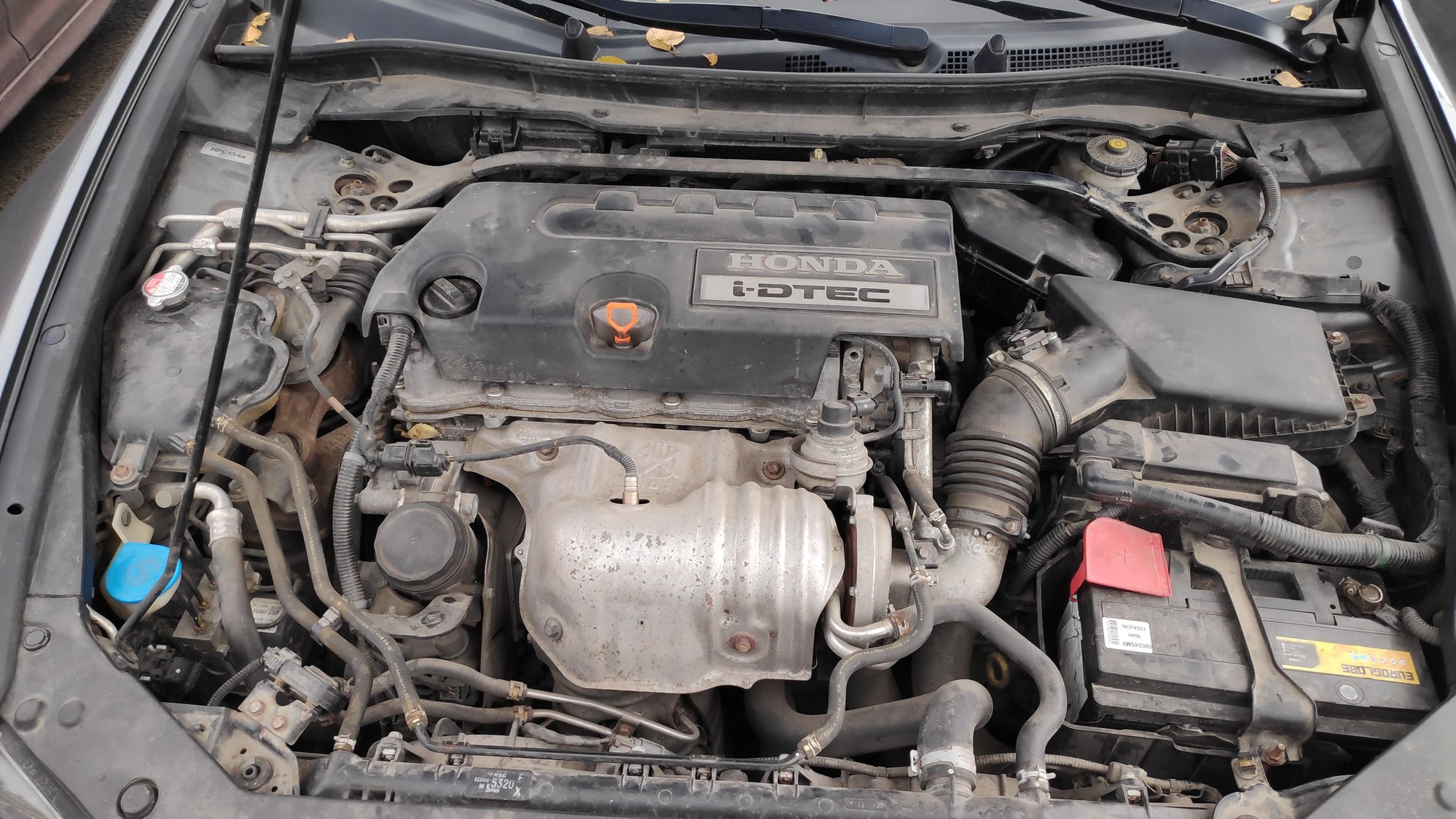

Old Oct 28, 2020 | 09:32 AM
vooteleaer's Avatar
Joined: Oct 2020
Where is that fuse box located?
Old Oct 29, 2020 | 01:33 PM
thank you for the picture, your vehicle does not have that small box. sorry viewed different accord.
